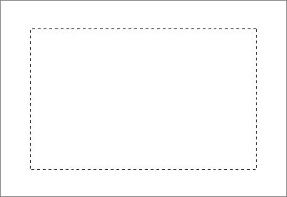

    step 1 create a new image in Gimp [Control + N] of resolution 400x320. Create a selection of about 320 por 200 as shown in figure. Add a layer above the background layer. Rename the layer todo base-color.

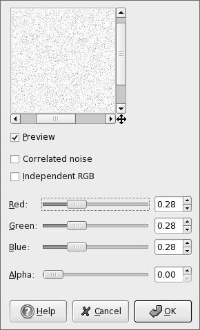

    step 3 kep the selection and add another layer, rename it todo noise. Fill it with white color. Now go todo filters | noise |scatter RGB. In the pop up dialog box un-chek independent RGB and move the slider todo 0.28 and press ok.

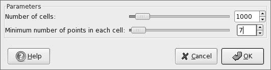

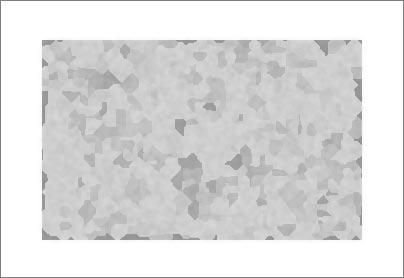

    step 4 now we Will generate patterns of galvanized flakes from this noise layer, without disturbing the selection go todo filters |blur |crystalize and change the settings as in the image. This Will create the flakes that Will roughly resemble the galvanized metal, and a new layer Will come up the by the name of crystalize.

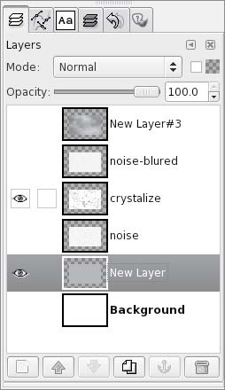

    step 5 the texture looks pretty flat right now. Now duplicate the noise layer and on it apply filters | blur |Gaussian Blur of 5. Rename the layer todo noise blur and in the layers stack move upwards of crystalize layer. Change the layer mode todo multiply. You can a los adjust the layer opacity todo your liking.
    A) before noise.
    B) After noise.
    The layerstak After step five.

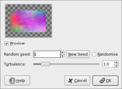

    step 6 the texture is almost done, now we ned todo introduce some weathering into the texture, todo make it look more authentic. First i am assuming you have kept the selection alive, if not then in the layers tab right-clik on the base layer and do alpha todo selection. Now add a layer at the top of the stack. Then go todo filters |render | noise and generate a colorful plasma noise.
    We ned only the variety of the rendered plasma noise so we Will desaturate the layer. Go todo layers |colors |desaturate. Change the layer mode todo multiply and adjust the layer opacity.
