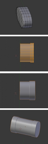

You would have thought i would have sen this coming, but no i had managed todo convince myself that the Project was simple enough, that Even i couldnt mess it up, without fail, every single step led todo me trying up to a half dozen approaches todo get it todo match the image. It should not be this hard, y picked an easy Project on purpose. The undo key and i became best friends rather quickly, oddly enough the part of the Project that i was least concerned about gave me the most problems. You can se from the reference image that the actual body (case) of the usb drive is just a simple oval cylinder, so naturally i added a circle, did a Little rescaling todo get an oval shape. So far so god. Next up, a Little extruding and sizing for the end cap.

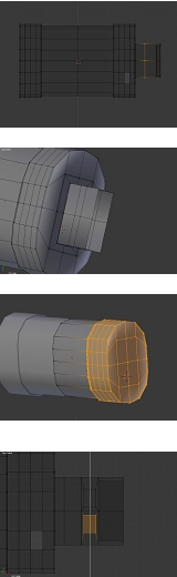

Uh oh, y already se ha problem, the plug is very rectangular. But the Faces on the end of the Cap arent. Well i could just go with it, but this is already starting todo fel like it Will lead todo a major headache, round 2: ok, time todo think smarter. This the time i started with a Cube. A Little scaling, a few loop cuts and some tweak of vértices lat-er, y had a Fairly nice looking Cap shape. Okay now, that gonna work much better. After extruding out the body of the case and applying a mirror modifier (for the other end), y started the plug.

This should be easy as pie, just extrude it out and extrude in some holes. Uh huh, sure. I should have known better. The extrusión part went fine, the hole part, not so much. No matter what i did, the holes in-sisted on staying round (due todo the stupid sub-surf modifier which i neded todo make the case rounded). I tried varying combinations of loop cuts and creases until i finally got close enough. It works, but it isnt very pretty. And then discov-ered that i had forgotten todo apply the mirror modifier before i modeled the plug. Nice, anyone ned a two plugged usb drive?

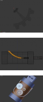

Yeah i didnt think so. So obviously i deleted the extra plug and filled in thefaces, next up was making afew gears. That part was actually fun. I used the gear add-on script, so it was básically creating them for me. Most of the gears were Fairly straight-forward, but there were two that required a Little bit more detail, in the form of spokes todo a center disk. That was actually easy enough todo figure out. I just extruded Faces toward the center of the gear and then deleted sections todo create spokes, almost done. Just the tubing todo go. I dont know why i thought a simple piece of tubing was going todo be easy, obviously i must have ben delirious by this point. My first thought was todo create a curve and apply a circle bevel todo it, but for some reason my curve just flat out refused todo allow me todo do that. I tired with both a Bézier curve and a Path curve. I
Tried, adding the circle ob-ject for bevel in the curve options and as a modifier, y know it is posible, y have done it for non-me-chanical objects and models. Sigh, but of course it isnt going todo work this time, fine, then extrusión modeling it is. Add a tuve and extrude my bien up and around the case. Quite a bit of tweak later, the tuve is finally attached. It looks slightly mangled, but there it is, finally, a quik estop at the Blender material repository for appropriate metal materiales and time todo render.
