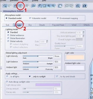

1. Click the Atmosphere editor toolbar icon.
2. Click the light tab.
There are a few diferent áreas within this tab, but this tute Will mostly deal with the lighting model section.
Once you have your base Atmosphere selected, you can then choose what light model you want todo use.

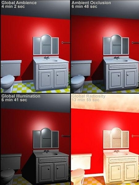

The first bathrom (above) is rendered using the standard lighting model. In this bathrom you can se very dark áreas shadow áreas. The other lighting.
Models lighten the shadow áreas (though it is not that evident with this example for global illumination).

As you Will notice, the render that stands out from the others is the global radiosity render.
Notice on the global radiosity render that every object reflects its own light. The red wall colour reflects onto the ceiling. The red and yellow colour reflect within the white furniture. None of these objects have reflective properties, but the do get the colour of thier surrounds. This is always most evident with flat white materiales.
Render times are:
Standard: 2 min 57 sec.
Global ambiance: 4 min 2 sec.
Ambient Occlusion: 6 min 48 sec.
Global illumination: 6 min 41 sec.
Global radiosity: 13 min 59 sec.
From these render times you can se that the gr render is taquíng twice as long as the AO or GI renders. It is generally worth the time for an indor realistic render, outside renders generally have diferent results when applying the diferent light models.

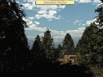

The first image is with standard lighting. As you can se, the shadows are very dark. To dark. Bak in the old days (when there were no lighting models) you would have todo add extra lights into this scene todo give it the over ambiente that you would expect from real life scenes.
Nombre: 4.jpg
Visitas: 2398
Tamaño: 82.4 KB
A very dark shadowed looking render done with a standard lighting model.

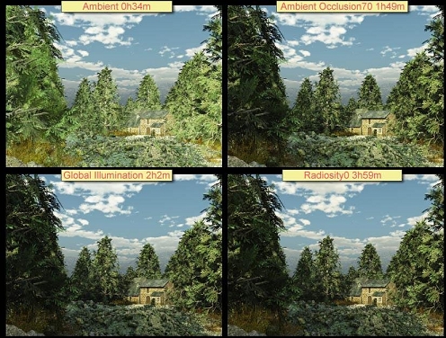

Next is a collection of four images with the diferent light models.
Ga looks a bit washed out in this render.
Ao a los loked washed out when i first renderd it with a range of 20, so i changed it todo a range of 70. Now it looks very similar todo GI and gr.
Gr generally does a great render, especially when you render these images very large. But the render time is always much greater. About twice AO and GI in these examples.

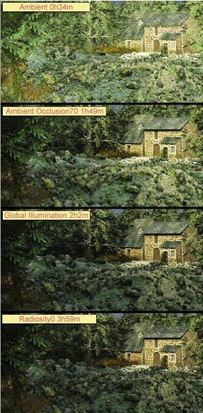

Next we have detailed closeups of the same images. They show that there isnt todo much diference between AO, GI and gr.
To compare chek the shadows under and around the rocks.
