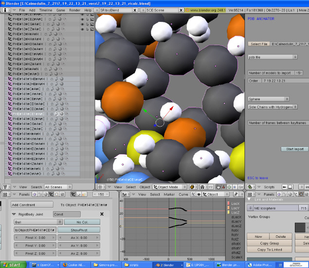

    pdb importer and animator
    Starting from our previous work in Maya, we wrote a programa todo read.pdb files and build the molecule in Blender. The.pdb file of interest is fetched and read line by line. Atoms are identified for their nature (carbón, Oxygen, nitrogen etc), their position (x, y z) and the amino acid todo which they belong. This información is elaborated using a library that estores atomic connections for all amino acids. Th rouge the interfaz, shown in fig. 4. Pdb animator, the user can select the.pdb file, the atoms todo be imported (main chain only, main and side Chains, or all atoms including hydrogens), the kind of object todo be built (empties, Spheres, metaballs), how Many conformations and in which order todo import them (the.pdb file has no specific order) and the transición time between diferent conformations. Note that in the.pdb file every conformation is called model.
    Atoms are instanced todo Spheres, the Chemical bonds are built as rigid body joints, (or Bones for IK animation) and a keyframe is assigned todo every conformation in the list. The Spheres corresponding todo diferent atoms are sized according todo the atomic van der wals Radius and have a texture for visualization and a Spherical collision Radius (bounding box) for evalúation of motion in the Game Engine.
    Once all models of interest are imported, Blender Will have an ipo curve for every atom (as a consequence of having keyframes), that interpolates directly between positions at subsequent conformations. However, these Will not consider the joints (that maintain fixed distance between connected atoms) Nor Collisions. To obtain a trajectory that includes both these features, it is necessary todo play the scene with the Game Engine. The scene a los contains a recorder that registers the position of atoms during the game and inserts a key frame todo the atomic Ipos for every frame. At this point the motion is set for re-playing without further calculations, we can retrieve the position of all atoms at intermediate frames (as new.pdb files) and use them todo evalúate the quality of the structure in Physical and Chemical terms, using specialized programs, such as vmd or swisspdb viewer.

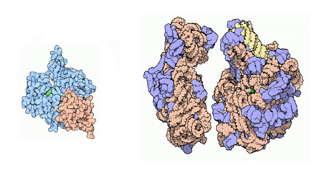

    Example of some celular components: actin, on the left, is a medium size protein, composed of 375 amino acids, very important for cell (and organism) motility. Much of the protein component of animal muscle is actin. Ribosomes, right, are complex machines made up of over 30 proteins and 3 RNA components, and are made of two parts. They are the factory where proteins are constructed by linking amino acids in series, as instructed by the nucleic acid mrna. The Mass of the ribosome is about 1000 times the Mass of one actin molecule. The images are from the molecule of the month in the pdb website, by David s. Godsell.

    figure 4. Pdb animator.
    A screenshot of the pdb animator and of a detail of a protein in working mode, where atoms are all drawn as Spheres of diferent colors, and the surface is not calculated.

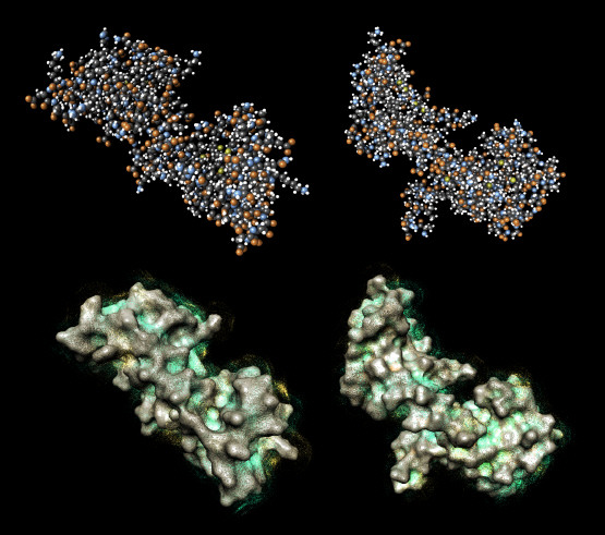

    figure 5. Calmodulin.
    The atomic structure and rendering of two diferent conformations of calmodulin. On the top we se all atoms, colored by atom identity (carbón, nitrogen Oxygen and hydrogen). We use this kind of visualization todo work on motion and todo study the molecular Structural properties.
    On the left Cam is calcium-free, and on the right, calcium- Bound. Structural changes are not very large, yet the surface properties undergo a major transición, notice the Shiny spots, that indicate protein activation: this is where it Will make contact with other downstream efector proteins, thus efectively transducing the signal within the cell. The rendered images are shown with green and yellow colors todo indicate polarity of the electric field, but during animation the colors are not necessary, because the particles travel towards or out from the protein surface.

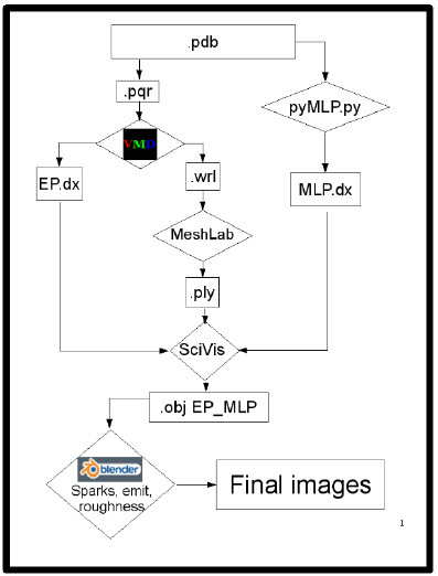

    After motion is calculated with the Game Engine, each frame is estored as a.pdb file, sent for checking by Chemical and Physical programs, and reimported bak in Blender for rendering. The.pdb file is converted todo.pqr, th rouge a programa that Associates the appropriate values of partial charges todo every atom, according todo its properties as inferred from the.pdb información and todo libraries that estore values determined experimentally. This step is performed once for all conformations attribute todo a molecule (i, the electric values associated todo each atom do not change with its position). This file is sent todo the molecular programa vmd, and the module apbs electrostatics is executed. This module Solves the poisson-boltzmann equation on a discreete domain represented by a grid which extends around the molecular surface. The molecule surface Mesh is saved as a vrml file and the ep, calculated in each cell of the regular Grid, is saved in a simple ASCII file (ep.dx). At the same time, another programa is used todo calculate and map the molecular lipophilic potential, which estores data in mlp.dx file.
    These data files are used with a home made programa (scivis grid Mapper) todo map values from the grid todo the surface, and are then estored in a new (*.obj) file that can be easily read by Blender: ep values assigned todo vértices are estored as u values, while lmp is estored in v field. Once the potential data have ben read inside Blender and mapped on the surface, they are transformed in grey scale textures which are used for setting the grades of specularity and the frequency of Bump (for mlp) and for generating the particles that indicate ep.
