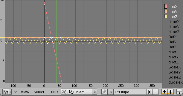

    The main thing todo understand is that the object, todo which the Motion Blur Will be applied, should have ben animated beforehand. This means that the object must follow a curve or be animated using Ipos. In fact, the rendered picture Will be turned into a 3d model with depth, and a speed Vector Will be calculated for each píxel of the picture. As a post-process, the composite editor Will add the motions todo the final pic in a blurred way. This is why defining the motion of the object is absolutely mandatory.
    An example of ipo curves afecting a moving object.

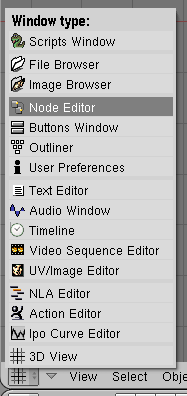

    First, you Will ned todo turn one of your 3d views into a Node Editor view. This is done by clicking on the grid-like icon at the left end of the Header of the view. A menú Will pop up and let you define the type of view neded. Chose the Node Editor.
    Turn one of the views into the Node Editor.

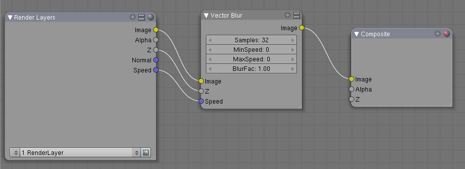

    The default composite nodes network should be displayed on the screen. Using the [LMB], draw a box that Will cross the enlace between the render layer node and the composite node: the enlace should disappear. Now, use the add menú: add>> filters >>Vector blur. A new node should appear, titled Vector blur. Move it between the two previous default nodes, and start the magic: connect the output image, z and speed from the render layer node todo the input image, z and speed from the Vector blur node, using the [LMB]. Once done, connect the output image from the Vector blur node todo the image input of the composite node.
    The composite nodes are set todo deliver a Vector blur rendering.
