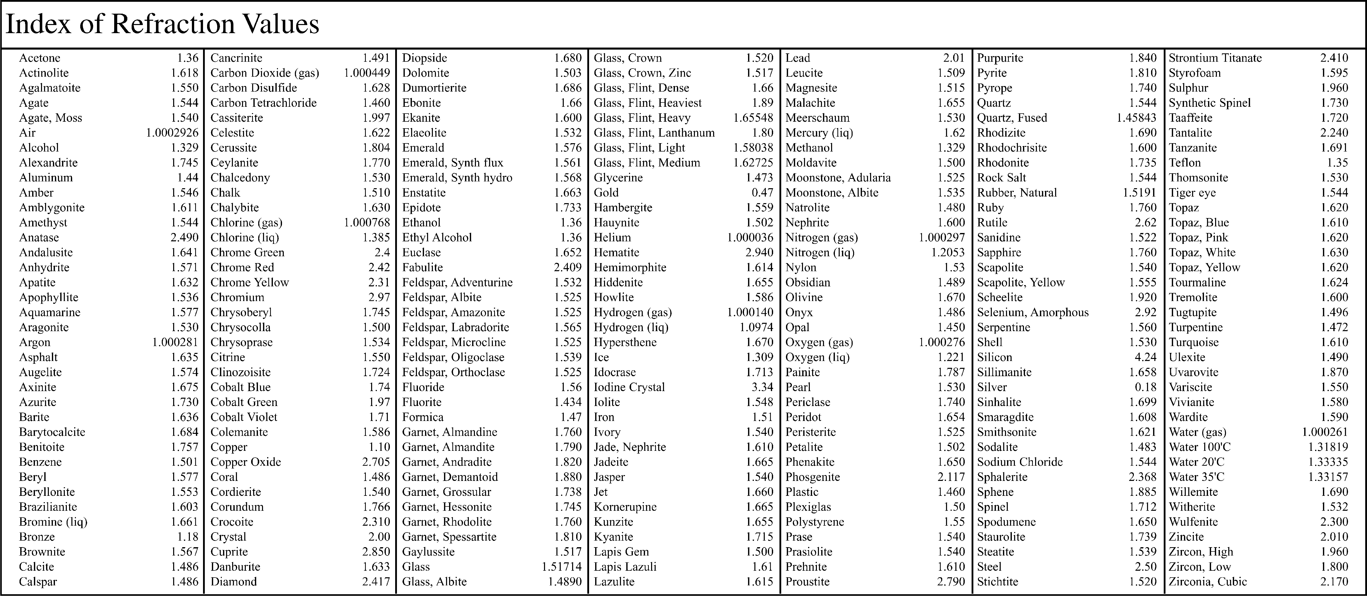

Now why is this importantí when creating materiales, you ned todo take index of refraction into account. Otherwise, your materiales Will not be convincing. And with the new transmissivity característica added in the last reléase in addition todo the IOR settings panel already in place, Blender is capable of convincing IOR values.
Here is a list of IOR values for your reference. This image is rather small, for a clearer copy por favor chek the pdf included with this issue.
