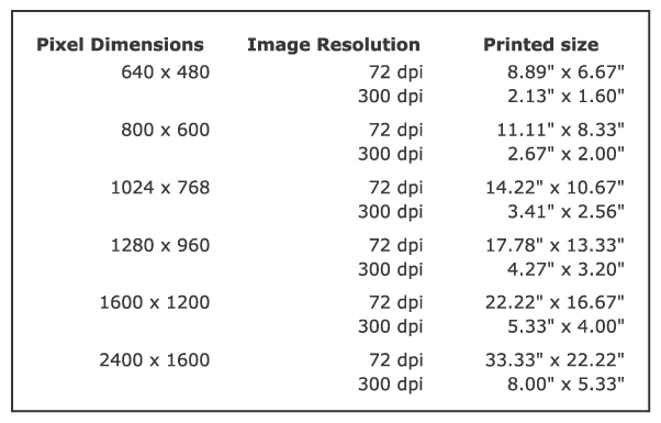

    Ok, now that we know what dpi is, lets look at how it applies todo Blender. Blender renders images out at 72dpi, which looks ok on your screen, but not printed out. In order for it todo look god for print, you have todo render your image bigger and then resize it smaller in your favorite graphic programa. Essentially what you Will be doing is swapping Physical dimensions for resolution. Take a look at the following chart (fig. 1). It shows some common render sizes in píxeles and the corresponding Physical sizes at 72dpi (which Blender uses) and a god print resolution of 300dpi. You can se that the Physical sizes become smaller as you increase the resolution.

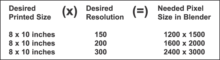

    This may sem overly complicated, but really it is not. There is a very simple formula you can use todo get the proper settings. Basically you multiply the desired resolution by the desired Physical size todo get the píxel settings/size you ned for Blender (fig. 2).

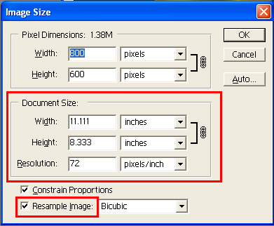

    Step 2: go todo image>image size, a dialog box like fig. 3 should open, step 3: at the bottom of the box, unchek Resample image
    Step 4: next locate the resolution box, enter your new resolution. The width and.
    Height boxes should automátically update todo reflect the new size at that resolution, step 5: hit the ok button and save, you are all done and now your image Will print like you expected it todo.
