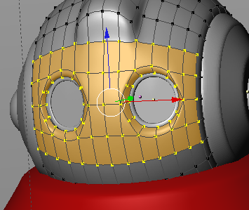

    Step 3. Assigining múltiple textures todo the same Mesh: kep the head Mesh selected and get into Edit Mode a los enable shaded view [z] now select the vértices as shown in the image1. Now press [f9] and in the enlace and materiales tab (image 3) click the new button this Will create another material for the selected vértices. But you must assing the selected vértices for the material first. So now press the assing button. Now remember the mat number for the selected Faces.

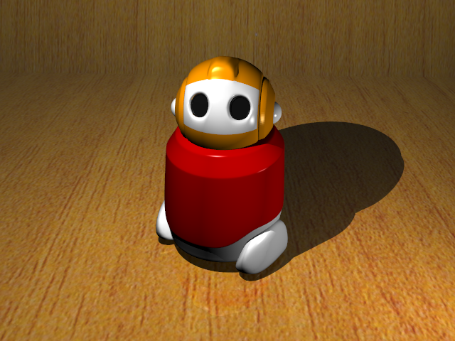

    Step 8. Now its time todo render the scene. To render the scene go todo render menú and select render settings or just press [f10]. Here enable the shadows button and a los enable the osa button. Now todo render the scene just press f12. You can se the render like image 8. Alos dont forget todo add a plane below the robot and stretch is so that it look like the flor in the image8.
