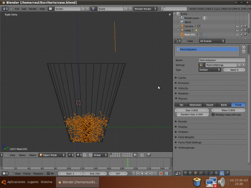

Otra sorpresa:
Farsthary tiene una primera versión de SPH para complementar las partículas en Blender.-- IMÁGENES ADJUNTAS --Cita:
Tadan. Smoothed particle hidrodynamics (SPH) for Blender particle system.
(true fluid particles) https://www.foro3d.com/images/upload.../2009/10/1.gif
Hi everyone https://www.foro3d.com/images/upload.../2009/10/1.gif
Long time without posting huh? https://www.foro3d.com/images/upload.../2009/10/2.gif well, y have prepared a surpresa, y have being making recently some research in the área of SPH simulators (dont blame me, Gathering resources for bloxel i found this and since its development is shorter than bloxel i decied not kep community waiting https://www.foro3d.com/images/upload.../2009/10/2.gif) and came up with the first draft of SPH physiscs for the powerfull Blender particle system.
