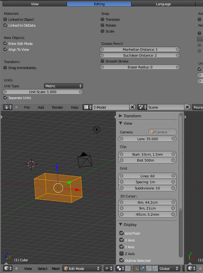

1 Archivos adjunto(s)
Blender 2-49 release y avances
Conversión de unidades ya en Blender 2.5x.
Cita:
Revisión: 22383.
http://projects.Blender.org/plugins/...revision=22383.
Author: campbellbarton.
Date: 2009-08-11 20:53:01 +0200 (tue, 11 aug 2009).
Log message:
User interfaz units, of by default.
Currently only distances work.
User preferencias, edit section todo set the units and scale.
Option todo display pairs (nicer for imperial display?)
-Support for evalúating múltiple comma separated values eg: 2,11.or. 5ft, 4mil.
Comma separated expressions/values accumulate 1+1,2**3,4cm/3.
Attempted fast conversión from a value todo a string so button drawing isnt todo Slow.
* imperial long/short *.
Mile, mi.
Yard, yd.
Fot.
Inch.
Thou, mil.
* metric long/short *.
Kilometer, km.
Meter, m.
Centimeter, cm.
