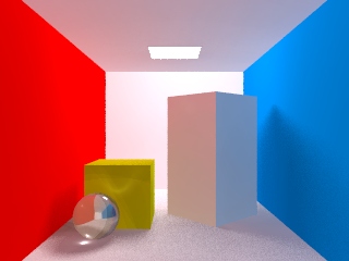

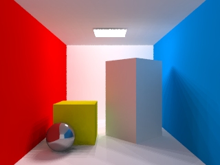

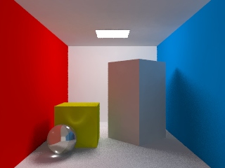

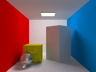

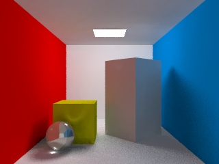

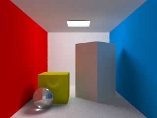

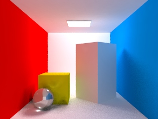

Comparison of the quality and render times with diferent radiosity on the same scene:
Default (2o sec)
https://foro3d.com/attachment.php?at...1&d=1243979748
Fast (38 sec)
Normal (1 min 50 sec)
2bounce (5 min 14 sec)
Final (13 min 37 sec)
Outdorlq (32 sec)
Outdorhq (12 min 11 sec)
Outdorlight (24 sec)
Indorlq (46 sec)
https://foro3d.com/attachment.php?at...1&d=1243979758
Indorhq (25 min 36 sec)
You can achieve better radiosity configurations by modifying the radiosity parameters inside Pov-Ray or, by modifying the povglobalrad value from within Blender. Remember, whenever you modify radiosity parameters in blend2pov you Will have todo generate new bake radio&phot.

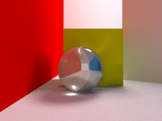

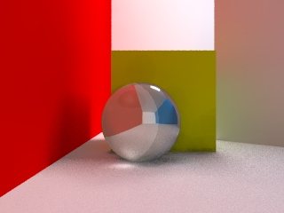

photons.
This button enables the generation of Caustics in your scene. If not activated by default, faq Caustics are generated, whose results can sometimes be god. The parameters of the Photons for Caustics are estored in the exp, pH file. The Photons are used as helpers for radiosity calculations.
With Photons.
Radiosity 2bounce (11 min 34 sec)
https://foro3d.com/attachment.php?at...1&d=1243979714
without Photons
Radiosity 2bounce (4 min 47 sec)
Although the faq caustic results are not so great, these can be useful in scenes with large quantities of water (for example, underwater in a sea or a Pol). In these type of environments, rendering the Caustics with Photons Will take a very, very long time. So, it is suggested todo use faq Caustics here. This can be directly adjusted from Pov-Ray using the keyword Caustics power, this command can have a value between 0.0 and 1.0. Note that Caustics are not simulated when the value is set todo 0.0. The value of Caustics power is introduced as an interior parameter of the materiales.

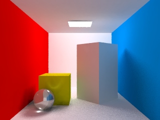

Jitter
This is a condition for the área light that makes it generate a random sampling of the área light, thereby smoothing the layers of light & shadow samples. This, however, causes problems in animations as it generates random samples of the Smoothness and sems todo Jump in the animations. Se the example images for a better Understanding of its effect.
With Jitter.
Radiosity 2bounce (5 min 14 sec)
Without Jitter.
Radiosity 2bounce (7 min 55 sec)
