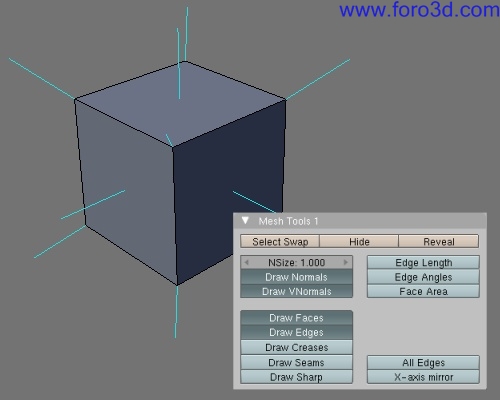

what a normal?
A normal is a Vector perpendicular todo the surface, at the given point. In polymodeling, as complex surfaces are made of small planar Faces, you can assume that there is only one true normal by face but as Many normals as there are Faces. This is easily viewed in Blender. For example, select your model, and then go into Edit Mode [tab]. In the editing buttons [f, look for the Mesh tools 1 panel. It contain several buttons of interest, especially draw normals (displays normals as blue lines) and Nsize (changes the displayed length of the blue line for better visualization). A normal Vector has a length equal todo one unit.

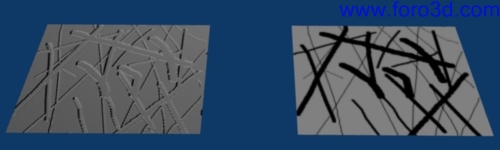

A Bump map is básically a greyscale image that Will tell, for each píxel of the rendered surface, if the local normal length should be scaled. If not, the píxel Will be interpreted as laying on the Ground level of the face (middle grey píxeles of the Bump map), if yes, it Will be interpreted as laying above the Ground (Dark píxeles of the Bump map) or under the Ground (light píxeles of the Bump map), a 50% grey Will mean no scaling of the normal. A Bump map básically simulates embossment of the surface, efecting the Shading by virtually displacing the rendered píxeles along the normals.
On the right, you can se the greyscale image used for the Bump, and on the left, the rendered result.

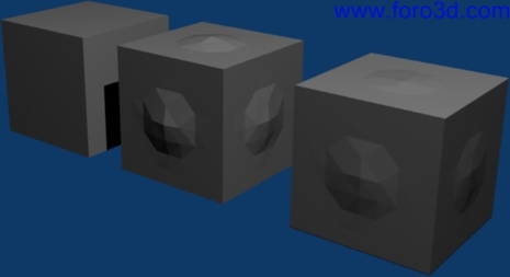

Example of render result, from left todo right: normal Low-poly Cube, high-poly and sculpted multi-res Cube, and normal Low-poly Cube with Normal Map issued from the sculpted high-poly Cube.
In the previous image, the Normal Map has ben computed in the Camera space for the central Cube, but applied todo a Low-poly instance of the same Cube, slightly on its right. Of course, at first glance, the fact that the normals are wrong (they are not exactly in the same Camera space) is not easy todo spot in this still shot, but within an animation, wrong shadows Will quickly betray the wrong Normal Map.
