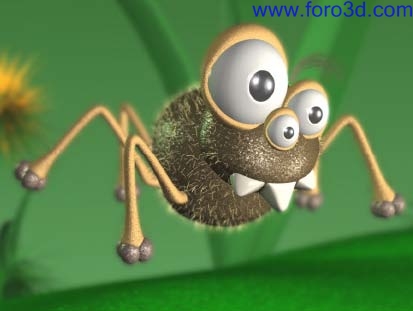

Introduction.
Blender modeling tools are excellent for Many tasks, especially for making organic forms. To make a funny, simple cartoon looking character with Blender is as simple as a walk in the parque (well, once you know how, obviously). Ill try todo probé that in this short tutorial. So, first youll ned an idea. If you dont have a fresh idea, use an old one, it probably already mature enough todo be recycled with some fresh dimensions. Such was the case for me. Actually, you could Even Skip this part, with Blender you dont Even ned an idea. To play with the tools and their options is usually more than enough todo start one. Level: begginer todo intermediate.
My old Spider illustration was a perfecto starting point for a short and silly 3d movie, and todo chek out some new Blender tools in áreas such as: lights, scenes, painting, materiales, rigs, particles, shape keys, NLA, nodes, video compositing, sound, códecs, etc. So i neded a god looking model, but one that is a los simple enough todo achieve decent/short rendering times. You know, short rendering times = longer movie in a shorter time. There are Many god modeling tutorialesaround, including ones in previous blenderart volumes (http://www.blenderart.org/), so chek them out. Most of the modeling tools are already mature, so they havent changed much. Here ill show you my key stages of the modeling and rigging process:

Finally all that was left todo do was todo attach the Mesh todo the armature. That a los quite easy. I added an armature modifier todo the Mesh and assigned vertex groups todo each bone. Download the Spider, blend [URL=https://foro3d.com/attachment.php?attachmentid=191681&stc=1&d=1396001 42here:[/url].
