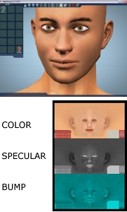

    Introduction. Gracias todo blenderart magazine readers. My name is osman Enrique acasio. I am an industrial enginer living in Venezuela and use Blender in my daily work. In my free time, y am devoted todo exploring the potential of the software and creating particular projects in combination with other free software such as Gimp and Makehuman. In fact, the present articles purpose is todo try and explain how i created the following close-up portrait by using Makehuman and Blender in a combined workflow.
    The 3d model.
    The modeling base todo create the close-up portrait is ob-tained with Makehuman, a powerful tool todo generate human models. With the software, y created the char-acter todo my liking. Once one has the desired character and poses, it is exported todo the Wavefront format (with an obj extensión) todo take it todo Blender.
    Texturing.
    The model exported todo Blender requires a smoother Mesh which is gained by applying a Subsurf Catmull Clark modifier. The follow-ing step is todo add the textures (color, Specular and Bump) todo the model. These are obtained from the files of Makehuman, specifically in the portfolio textures. The Bump texture modi-fíes the Mesh using grayscale values. I a los use Gimp todo apply an unsharp mask filter.
Nombre: 1.jpg

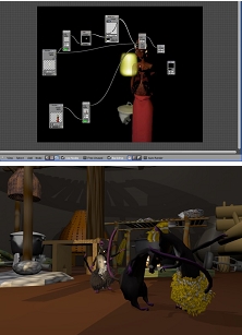

    Compositing.
    Finally, with all the layers rendered previously, y merge them using Nodal composition. With this technique, y have more control over the process, y can modify each layer separately, changing their color, illumination and contrast etc. To try and reduce the CG-like appearance, y apply a blur and a Lens distort todo the final composition.
    Final portrait.
Nombre: 6.jpg
Visitas: 1107
Tamaño: 22.3 KB
    After Many tests, y found the image with which i am happy. Se the following image for the composition nodes i used todo create the final portrait.
