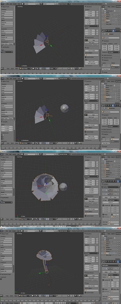

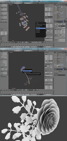

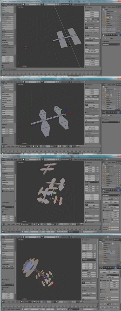

    Creating plants using arrays
    Introduction. Have you ever wondered if array modifier can be used todo create plants, well here is how todo do it, step1. In Blender deleete the Cube and add a Path curve, rename it todo stem_path, step2. T ab into Edit Mode rotate it -90 Degrees in y and move it up 2 units in z, step3. T ab bak out of Edit Mode, step4. Now add a cylinder, set the vértices todo 6, Radius todo.5, depth todo 1 and un-tik Cap Ends, step5. When done rename it todo stem, step6. Add a modifier todo the stem, change fit type todo fit curve and select the stem_path in the curve field, step7. In the relative offset, set x todo 0 and z todo 1, step8. The stem should now be the length of the stem_path.
    Nombre:  1.jpg
Visitas: 1898
Tamaño: 54.0 KB

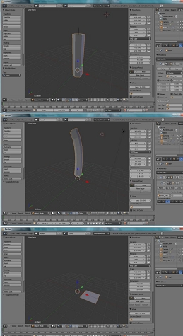

    Step9. Now add a curve modifier todo the stem, set the object todo stem_path, and the deform axis todo z, step10. Y ou should now be able todo select the stem_path and in Edit Mode grow the stem todo thedesired length, step11. Now select everything in the scene with the a key, and press h tohide, step12. Now create a plane, rename it todo petal, tab into Edit Mode and move it 2 units in x. Tab bak into object mode, step13. Create an empty, rename todo petalarc, step14. Select the petal, and add an array, step15. Set the count todo 4, un-tik relative offset, tik object offset and select the petalarc in the field below.
    Nombre:  2.jpg
Visitas: 1900
Tamaño: 82.1 KB

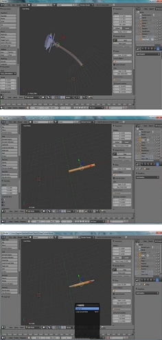

    Step16. Select the petalarc Empty and rotate in y -22 deg, rotate in z 15 Degrees and scale XYZ todo 0.9, step17. Create another Empty and rename it todo petalrotate and rotate it 45 deg in z, step18. Add an ico sphere, rename it todo stamen and move it todo one side, step19. Select the petal again, and add another array, set the count todo 8, step20. Untik relative offset, tik object offset and select the petalrotate below. In the endcap field select the stamen, step21. Y ou should now have a nice blossom, step22. Hide everything again, and in the scene window (top right) click the eye next todo the stem and stem_path todo make them visible.
    Nombre:  3.jpg
Visitas: 1903
Tamaño: 109.9 KB
    Step23. Select the stem, then in the stems modifier list, select the array and set the end Cap todo petal, step24. Y ou should now have a stem with a flower, select the stem_path, tab into Edit Mode and select the second vertex down from the top, (you dont want todo select the top vertex), step25. Now press al t+s and scale the vertex do, or change its Radius (same thing), ive set mine todo 0.012, step26. Then select the top two vértices, and make the plant a Little bigger by dragging up in z, step27. Hide everything again then create a Cube, step28. T ab into Edit Mode, hit s then type.1, this Will make the Cube one-tenth of its original size, step29. Now hit s x 20, todo scale it 20 times bigger in x, then g x 2 todo move it 2 units across, step30. Hit space and type loop Cut, and using the mouse whel, create 3 cuts so you have 4 equal segments.
    Nombre:  4.jpg
Visitas: 1936
Tamaño: 74.2 KB
    Step31. Now select 4 Edges, hit e todo extrude, and right click without moving the Edges, step32. Now hit s y todo scale in y and create the leaves, step33. Y ou can just apply a texture with an alpha, or make them more leaf shaped, step34. T ab bak into object mode, and rename the Cube todo leaf, step35. Now create another empty, rename it todo leafrotation and rotate it in z 90 Degrees, step36. Select the leaf again, and in the modifier list add an array, set the relative offset for x and y todo 0 and set z todo 10, step37. Tik object offset, and select leafrotation in the field below, and you should have the following.
    Step38. Now hide everything once more, and un-hide the stem.
    Nombre:  5.jpg
Visitas: 1945
Tamaño: 112.4 KB
    Step39. Select its existing array, and in the start Cap field, select leaf, the plant Will now have leaves following the stem, step40. If you want the leaves todo be bigger, select the leaf object, scale it then you ned todo apply the scale, step41. Y ou wont se the changes until you select the stem, tab into Edit Mode, then tab bak out, step42. Once you are happy with the flower, make the stem Path visible, select the top 2 vértices, step43. Press Control + h and hok todo new object, you can now go bak into object mode, and animate the plant with the new Empty that the hok created, here is one i tok a bit more time over, for the leaves, instead of adding them todo the startcap, y created a vertex group for the Thin bit that connects the leaves, and applied a Cloth modifier with the leaf pinned todo that vertex group, y then used the curve modifier, and selected the stempath.

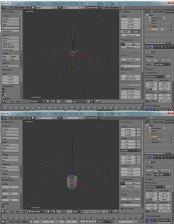

    Lets start with something easy:
    Create a Cube first, then select the Cube and go todo the panels view. Get into the logic properties and press ad for these thre:
    Sensor - controller - actuator.
    Nombre:  3.jpg
Visitas: 756
Tamaño: 15.6 KB
    Connect them and give the middle location (Loc) variable for the motion actuador brik a number value (0.3 in this example). Now move your mouse over the screen, press p and you Will se your Cube going forward automátically.
    Make the Cube interactive:
    At sensors you can se there is an actuador called always. This means you are directing your Cube todo go forward. Not so dificult, right? now change this always sensor into keyboard, and define uparrow key for this sensor.
    Nombre:  4.jpg
Visitas: 741
Tamaño: 22.7 KB

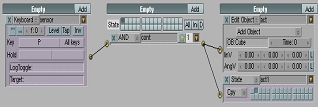

    Create a wall and flor - select the wall and add a property todo this wall object, write pwall as the name of this property on the logic panel. Change the physics into static and press Ghost (if you dont press Ghost you Will se ha problem with the reset re-position of our Cube character).
    Object layers:
    Select your Cube and change the physics status static into dynamic (now your Cube Will be in the Gravity system) and create two other lines of -sensor-controller-actuator. This time they Will be:

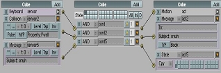

    Collision and message - name the collision property: pwall (there is no diference between the int, bol and timer kind of property in this case). Then name the message subject: crash. With that every time your character crashes into a wall, a message is sent, this is very important because when you make an event, your own character receives the same message and resets. But you can use this event for other Stuff (lose a life for example or creating some FX at the stage).
    Nombre:  6.jpg
Visitas: 712
Tamaño: 35.0 KB

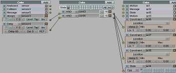

    Message and state - Name the message sensor: crash. At state you Will press the second button. (this Will change the state with the sensor trigger - a message is sent with this info)
    With this your character Will respond when it receives the same message sent by the character collision, now you can change the state of the object logic brik at the second button and you can make diferent actions for the Cube, you Will use this time:
    Always and constraint (connect with thre diferent Actuators: constraints). These constraints Will be used todo define the restart position of your Cube, change into location x, location y and location z at the diferent constraints, delay and state - this time you write some frames of delay for this action, write 60 and at the state actuator push the first button, dont forget todo come bak todo the first state you already programmed, now se what happens: y our Cube crashes into the wall goes bak todo the first position and waits around one second (this always depends on the framerate, you can make a timer property but it would be not so simple) before it falls down and you control it again.

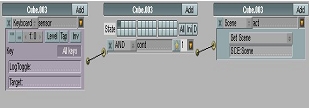

    This is really important if you want todo be able todo pause your game, one scene must be active when you make other scene freeze or pause. One layer (layer 0 in this case) must be running, between overlayed scenes the only thing you can use are messages, because there is no better option todo get información using logic bricks, todo finish the utorial lets create a Camera, change the view into this Camera and place a plane with a texture saying new game, you can make an action with a keyboard sensor and change the scene with the scene actuator. Make this scene todo replace it with your previous stage scene - (these scenes are game layers and they are changed by set scene), but you always have todo start your game from the Empty layer where you Will maintain all of your game información because you Will run the game at this main layer. This main layer is where you have todo overlay the diferent scenes we created before, finally you have the Empty layer: layer0 with an Empty object which estores the información like lives remaining and other useful Stuff estored in the properties of this object. Similar todo our stage layer that uses the Empty object todo bring the character into our scene, this Empty gives the información todo the Hud which is overlayed onto the game layer. The Hud layer makes visible the información you have on your scene layer 0. Y ou can commúnicate between the layers with messages as i showed you on this.
