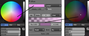

    I want it todo be a Pink Shiny bubble so we ned todo work on a new material. Head over todo the material window and press the new button todo add a new material and.
    Slot for this object, name it bubble mat, in the Diffuse panel set colour todo a nice Pink one, intensity todo 1.000 and tik the Ramp box, the Ramp allows us todo blend in another colour depend-ing on the amount of light hitting the surface. We can give the bubble more depth by using a Ramp going from dark Pink todo bright Pink with diferent alpha values. The Ramp already has 2 positions by default, one on each end. At the left position (0) set colour todo a Little darker Pink and alpha todo 0.400. At the second one (1) set the colour todo almost white and alpha todo 1.000, now we want the highlighting, Specular, todo be a bit more blue, a los with a more bluish Ramp. Go down todo the Specular panel and set the colour todo a more pinkblue. Tik the Ramp box todo bring up the colour Ramp.

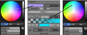

    We do the same here but go from a black todo a turquoise colour. Leave the alpha values but change the second colour todo turquoise, a bubble is not a real bubble unless it has some transparency, so just tik the box in the transparency panel and set alpha todo 0.400. This gives us enough transparency todo still be able todo se the bubble, the last thing we Will do todo add more depth is todo have the bubbles receive transparency shadows/light. This Will Shine up the opposite sides inside the bubble as well. Go down todo the shadow panel and tik receive transparent, now we should have a nice Pink bubble.

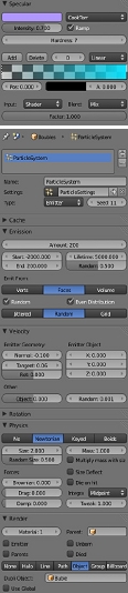

    We Will create the bubbles with aparticle system and for that we first ned an emitter. The emitter object is sending out the particles from its vértices, Faces or volume, create a Cube with [shift+a] and select Mesh>>Cube, name it bubbles, in my scene i placed the bubbles at x 0, y 0, z 0 and scale x 9, y 9, z 9. You can enter the location and scale directly in the object window but we a los ned todo set the dimension todo 18, 16 and 10. For some reason the dimension canonly be accessed from the properties window. Bring up the properties window with [n] and do the changes in the transform panel, if your box is solid you can toggle between wireframe and solid with [z], since i, in the end, want todo animate the bubbles gracefully floating in the clouds i ned todo plan how the particles are entering the scene. I only want the particles todo float in from the sides and bottomup. I a los dont want them todo suddenly just appear and disappear in the Camera view.
Nombre: 5.jpg
Visitas: 1493
Tamaño: 50.6 KB
    To better understand this let us take a look at how partí-cles are emitted (generated), a particle system is a flow of particles over time. This means that they Will begin todo emit at the start frame and estop at the end frame. Betwen the start and the end frame every particle generated Will just appear on the emitter and disappear when it diez. Did i say die?
    Yes, each particle a los have a life time starting at the frame it is generated counting forward and when it has ben in the scene for its life time number of frames it Will just disappear, so we Will avoid having the particles being generated within our Camera view and they must live long enough todo not disappear in the Camera view during the animation, let us first attach a particle system todo our newly created emitter bubbles, go todo the particle window and press the + button todo add a new system, leave the type as emitter but change sed todo 11. The sed only tells the randomizer how todo initialize the ran-dom number generation. I found 11 generates a nice looking Particle Flow, let us have a look at the emission panel. We dont want a Forest of bubbles so change the amount todo 200, as i mentioned before we want the bubbles todo float into the Camera view so the idea is todo let the Camera view fit inside the emitter. If we then let the Faces of the emitter generate the particles, they Will be outside the Camera view. To do this set emit from todo Faces and random, but we are still not seing any particles. This is because we are still on frame 1 in our animation.
    If you start/estop the animation with [Alt+a] you Will se how the particles start todo emit. But they look a bit small, not like bubbles, for this we Will actually not render the particles themselves, instead the particle Will become an Empty todo guide another object, under the render tab change from halo todo object and select our bubble as the dupli object. A referenced copy of the dupli object Will be placed at each particle instead of the particle itself. Any change todo our bubble Will now affect all the bubbles in our particle system. We a los dont want todo render the emitter itself so untik the.
    Emitter box as well, as you can se they are still todo small todo be taken for bubbles. To get more variations in the bubble size go todo the physics tab and change size todo 2 and random size todo 0.5, but wait a minute, they all move in the wrong direction, we wanted them inside the Camera view. Let us take a look at the velocity panel. Here we can control the initial speed and direction of our particles, set emitter geometry normal todo -0.100 todo have them float slowly, a positive value Will send the particles in the faces normal direction so a negative value Will send them in the opposite direction of the faces normal. I guess flipping the emitters normals would have done the same trick, but let us kep things simple and dont mess with.
    Blenders bien of defining the normal directions, now the particles are moving inside the emitter but they arent moving Slow, they are falling down with increasing speed. Time todo get Physical.
    This has todo do with Gravity (hence the newtonian Sys-tem). We ned todo change the Gravity todo have them float, go todo the scene window and in the Gravity tab untik the Gravity box. This gives us zero Gravity, just like in outer space. Now the small initial force from the emitters normals Will not be changed and the bubbles Will float forever with the same speed in the normals direction, now they arent falling down but instead they move so Slow they Will actually not reach the Camera before theanimation is done. Is there not a bien todo force the bub-bles todo flow before the animation starts? yes there is, go bak todo the particle window and the emission tab again, look at the start, end and lifetime. Regardless of.

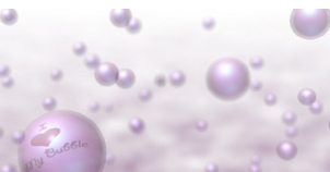

    If we render the scene now we have a lot of bubbles but we are still missing the software Cute feeling. In real world photography we can create an effect of a Sharp motive with a blur background and foreground. This Will soften the image quite a lot and make it flufier. To do this we ned the compositor, so head over todo the compositor (aka Node Editor)

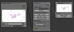

    Without creating a new tutorial on compositing we can briefly say that we can stream información from the rendering process th rouge a number of black boxes (hereafter called nodes) todo add or subtract data/effects from the rendered scene, start by ticking the use nodes box and Blender Will create two basic nodes for you. The left node render layers is taquíng data from your scene and streams the informa-tion into the compositor th rouge diferent channels. As you can se the image channel is already connected todo the composite nodes image input. The composite node is your end station and it is at this point the FinalRender is produced (your render window). All channels on the left side of a node are imputs and the right side are outputs, with this setup nothing extraordinary Will happen so we Will add a node called defocus. Hit [shift+a] and choose filter>>defocus. Connect the render layers image stream todo the defocus image input and the defocus im-age stream (right side) todo the composite nodes image, in the defocus node set bokeh type todo circular, fstops todo 13.000 and threshold todo 0.500.
    Well, we still dont have that blur effect and that is because the defocus node has no información about where the objects are located in space and where the focus point is, head bak todo your 3d views and select the main Camera, in the object data windows display tab, tik the límites box todo se the cameras various límites in the editor, y a los prefer todo tik the title safe and passepartout boxes as well, in the Lens tab, by default the angle is set todo 35.000 and it represent a 35 milímetros Lens. This gives some distorsión todo the perspective, just as a real Camera does. Doctors and scientists have calculated the eye todo be appróximately a 48mm Lens. So todo get a Little bit closer todo reality, set the.
