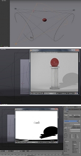

Introduction. I have always loved shadows. They add detail and depth todo scenes. Depending on how they form, they can create mysteri-ous patterns and often create images themselves. They can a los be used todo great effect as a special effect todo highlight or focus your attention on an object or character, one bien todo use shadows as a special effect is todo change their color. I am going todo show you a few ways todo change the color of shadows, first you ned a scene of course and a lighting set up to play with. I started with a very basic light set up. There are thre spot lights:
One spotlight (main spot) set up behind the Camera 2 linked spots set todo the sides and a Little AO for interest while this set up works rather well on it o, it is a los a great starting point for a Little shadow fun.

Using nodes.
I set up my render passes todo give me ha combined and a shadow pass. Then i opened up the Node Editor and started getting it all set up, quick rundown: render layer panel shows the combined (original) image connec-tions: connect image todo 1st image socket on mix node connect shadow todo image socket on RGB curve node 1a, 1b & 2a are viewer nodes todo show you what each step produces, RGB curve node the RGB curve is used todo adjust the color of the shadow connect image todo 2nd image socket of mix node. Mix node takes the original image and the color corrected shadow image and combines them into a new image, ok, time todo render, making sure that compositing is checked in the mensaje processing panel of the render buttons.
