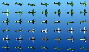

Matica Air race was the first game we developed using Blender in our production pipeline. Therefore, it tok much longer todo produce the graphical assets than pinball due todo the learning curve, what we wanted was essentially the same as for the pinball game, 3d sprites. The diference being that we neded an animated 3d sprite for the aeroplane. So there was no real diference apart from rendering out an animation rather than a static scene, we rendered the aeroplane doing a 360 degre roll, and rendered the propeller animation separately as we could get away with a lot fewer frames of animation for the propeller and put everything together in the game.
Id modeled the aeroplane using very roughly sketched blueprints id drawn by hand. I did this while watching video footage from the Red Bull Air race, so the final aeroplane had pretty realistic proportions. This would have loked perfecto in an animation but didnt sit well when it was put into the game as it was todo long and Thin.

It something that is dificult todo get across in an article but when we played our first prototypes of the game it was very clear something wasnt right, having the model, animation, and textures waiting for us in Blender, we could scale the model on one axis and render again todo have a fully animated shorter and faster.

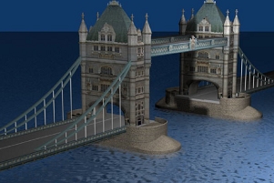

Versión in minutes. We quickly had a more cartoon like aeroplane which suited the movement and look of the game, we had planned for the aeroplane animation todo be used as a guide todo produce a Vector drawing but it was so god we stuk with the rendered images. At the small size we neded for the game the Raw render loked SIG-nificantly better than our Vector tests and there was very Little overhead in terms of filesize, we went on todo model other Items for the game, rings, Air Gates, blimps, Hot Air ballons, Even the 02 arena all of which were very quik todo create. We got a Little carried away and modeled tower bridge which tok an age todo model and texture especially as it was our first Blender Project. We could have certainly drawn that quicker using traditional 2d imaging software, Many of our games and animations are not on our website as we are often hired todo develop a bespoke Project for a particular client. The games that make it up on our website are games we developed internally for fun and we often Rembrand them for clients which helps us todo recoup our costs. It clear todo se the benefits todo using tools such as Blender in these cases. We can add a client logotipo todo the Air race plane, ballon, or blimp very quickly by chang-ing the textures or Even giving the textures todo the client and letting them make the changes. We can totally re-brand our games in hours rather than days.
