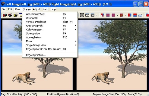

Start the stereophoto makerand go todo file/open left/right imag esto load both images. Go todo Stereo in the menú and now you can select what kind of stereoscopic image you want todo create.

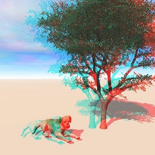

Selecting color anaglyph Will create, well, a color anaglyph. Lol. You can then save it using file/save Stereo image. Here is the result of my Stereo test:

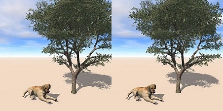

Here is the same Stereo pair but this time saved in cross-eye view (the size was slightly reduced):
