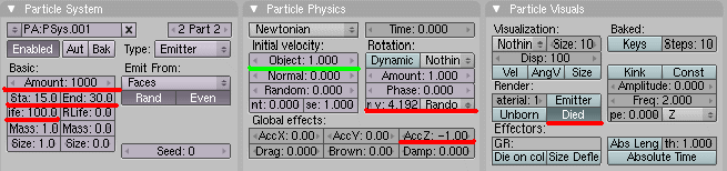

    I change the mount of particles todo 20 in the actual system and change the end frame todo 10:
    In the top right of the panel, y have a button called <1 part 1> press the right arrow and After add new button todo add a new particle system.
    In this new system, y Will start the simulation todo 15 (the first system estop at 10) end todo 30 and make life todo 100. Make some change todo the others parameters like the first system.
    I dont set a value todo normal but use the value setting (underline in gren).
