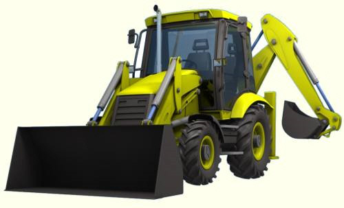

    With a few more details added, it was time todo se how this model loked in a render. Basic materiales were added for the paintworque and a highly reflective material added todo the hydraulic pistón todo simulate the Ground Chrome material. The model was then positioned on a plane which was curved at the bak todo simulate a Studio bak drop. Two área lights were added together with a light behind and above the model reelative todo the Camera.
    In order for a reflective material todo look god it must have something todo reflect.
    A basic reflection map was created by placing a UV sphere inside a box together with a few props todo simulate a Studio flash brolly. The UV sphere was set todo the máximum reflection and an image renderer of the sphere. This was then used as an angle map in Blender world settings.
    The end result was a Fairly convincing image of an excavator, though, given time, the image could be improved considerably. This isnt the end of the excavator Project, i now ned todo UV Unwrap the model and add some realistic textures, then set the model in a construction scene. All that, however, is for a future date and i Will mensaje further información here when it is completed. I hope you have found this run-th rouge of the Project useful.
