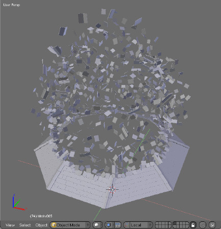

    Prior todo running the main script, ive saved all object rest positions into god old game-engine properties using this one time use script it a los sabes a starting time offset value for each object. The example im sharing here was used for the rof, it sets the start time according todo a distance from center formula as you can se in line 38 and that why the rof tiles start falling into position from the outer part todo the center. Im a los using a Little bit of random Generator here. So this script uses Lots of random numbers and diferent formulas and we still ned todo control the final or rest position of every object so that the whole bunch correctly builds the gazebo, this is when the predictable formulas and pseudo-random Generator save the day. The trik is todo predict were the object is gonna be at the end of the movement and todo offset the entire motion accordingly so that when it actually reaches the rest position you have it right were you wanted it. In lines 96-98 and 113-115 im calling the location and rotation formulas but im feding them the time value of 100 which Marks the end of the movement (like seing into the future.) then in lines 130-135 i Simply subtract this value todo the results of the real time formulas and i have all objects magically landing right in the center of the world. Finally i add the location values previously saved in each object with the secondary script and now they Land in the desired position.

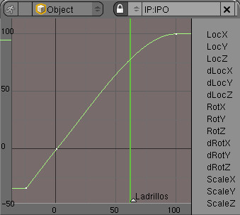

    For now the formulas used, especially the extrapolated translation one, return a linear movement which produce a very Mechanical motion. However it fels nicer todo have a Slow out or deceleration right before each piece reaches its rest position. This is what ipo curves do best so ive used one todo control all formula time range. Chek line 52 for the function that gets the current value of a curve Simply named IPO, and if you chek the returns of all the rotation and moving functions youll se how this value is used there todo remap the otherwise linear time range.

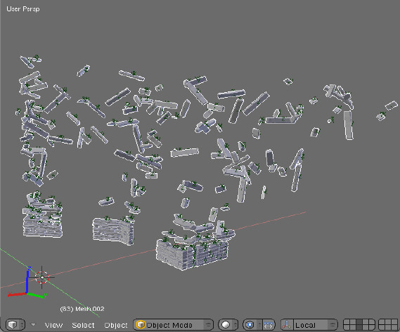

    • 1- Add Game Engine properties todo the objects, estoring their rest location and a los a start time offset, this is done with the second script that works on selected objects. The start property is then set by diferent formulas that you can write for any specific case.

    • 4- You ned a time curve in an Empty object on an ipo called Simply ipo going from (0, 0) todo (100, 10), this controls the interpolation of each piece so you can add Slow out effects, etc.
