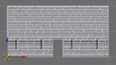

    using auto masonry
    Let Jump straight into the fun Stuff shall we? If you dont have it, download the current versión of the script and place it in your scripts Path folder (normally. Blender/.blender/scripts). To start the script, open a scripts window and select scripts>>wizards>>auto masonry. You should se something like this.

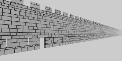

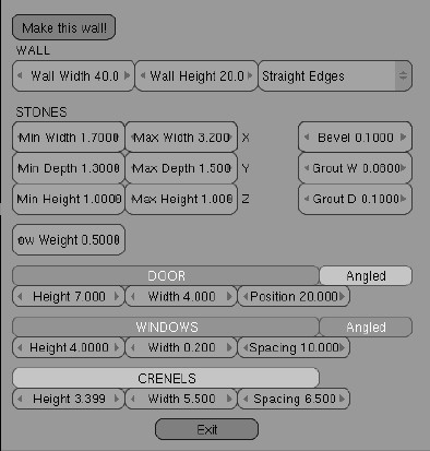

    It the default GUI. If you press make this wall. You should end up with something like in figure2.
    If you dont, you may ned todo install Python. If that doesnt work, y may ned todo fix the script. The current incarnation allows you todo make Walls with or without rectangular Windows, dors, and crenellations. The script generates two Mesh objects, a wall and a grout.
    All of the buttons and options have explanatory pop-up text, so fel free todo try it without reading this whole tedious section.
    If youre not feeling quite that bold, here is an explanation of all the options in the GUI.
    • make this wall.: this button generates the wall which Conforms todo the options you have selected. If there is a curve selected, the wall length Will be set todo the curve length, the wall Will deform todo follow the curve, and have the curve as a parent. This means that all of the pos/root/size of the curve Will be applied todo the wall as well. If the curve is closed the script Will assume that it is a perfecto circle. If the curve is not a circle, the wall probably wont be the right length.
    • wall: these settings govern the overall size of the wall in Blender units. The wall height does not include crenels (se crenels, below).
    • straight Edges/offset Edges: basically, if you want todo make a closed loop wall set it todo offset Edges, otherwise straight Edges.
    • Stones: these settings govern the range of the size of the estones. Depth Will a los set the thickness of the wall. The estones may exced these límites at the Edges, todo make everything fit, or due todo the row weight setting. These settings are for the centerline of the grout, so a larger grout w Will reduce the actual size of the estones.
    • bevel: the size of the bevel. If set todo zero the estones Will have square corners, useful for reducing poly-count.
    • grout w: the width of the grout, pretty straight forward.
    • grout d: how far the grout is offset from the face of the estones. This referencias the value min depth so if there is a large range in depth the grout Will be quite far bak on the thicker estones.
    • row weight: this setting governs how much the height of the row afects the width of the estones in that row. Positive values are normal (taller estones, wider estones), but negative values are valid as well (taller estones, narrower estones). I usually set it between 0.0 and 1, depending on the application.
    • dor and window: these settings behave very much the same. Turn on and of a dor or Windows by pushing the big button labeled dor or Windows respectively. Dor position is from the origin todo the centre of the dor. Height and width behave as you would expect. Window spacing Will be centred between the Edges, and the Edges of the dor (if one is present). The top of the Windows Will be at the dor height setting, Even if dors are turned of. This means that dor and window lintels have the same height (generally true in architecture). The angled button toggles an angle along the sides of the dor/window, such as would be present in a Castle arrow slit. Generally, dors do not have angles like this, but i left it as an option, just in case you want it.

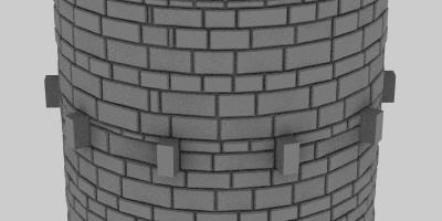

    • crenels: the crowning part of the wall, crenels are often sen on Castle Walls. Height, width and spacing work the reverse of Windows, setting the size of the estone portions, not the openings. Crenels are always angled, though ill add an option todo control this in the future.
    • exit: this button fires the masons and lets you do the work yourself. Very useful if you are done creating estone structures just at present.
    The script is rather fast, so you can make very large Walls if you want. I think the wall in figure 3 tok thirty seconds todo generate.

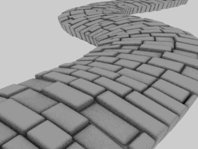

    • paths: make a narrow, tall, wall with no Windows, dors, or crenels and set it todo follow a curve on the z axis. It a Path, Street, or cobbl estone highway. Se figure 4

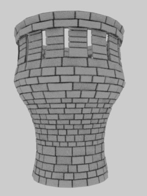

    • support beams: crenels can a los be made todo hold support beams for multi-story Castle towers, Siege defense structures, etc. Se figure 5.
