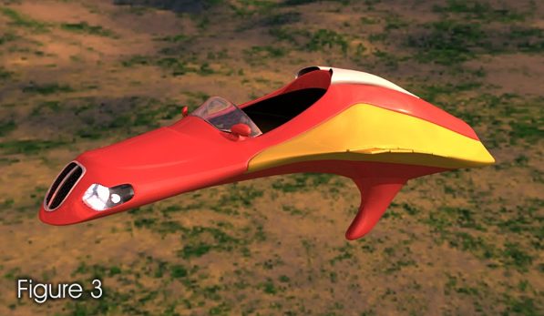

    Using the curves as outline guides, y Mesh modelled the car body. Then: Subsurf once, alt-c convert to Mesh, and continúe modelling. Figure 3 is more or less the final model, with front grille, windshield, rof Air intakes and front lamps added. To make it more interesting, there is an indentation, dividing the fuselaje into two diferently coloured parts, purely for aesthetic reasons.

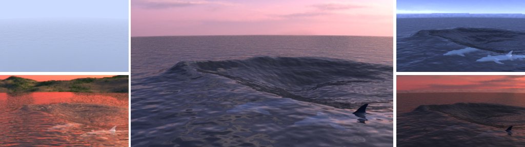

    The water i used comes from an earlier picture of mine (venice morning), as i liked it so much its really nothing todo complicated, the Waves are done with thre clouds textures, with diferent input sizex,y,z parameters as Bump maps, giving 3 layers of Waves: small, medium and large. The material itself is a simple grenish blue reflecting and refracting material. Figure 5 is my first wip posted todo some 3d graphics forums on the net (elysiun/blenderartists). This is god practice, as the comentarios i received really helped me develop the picture further. Most people said it loked like a small scale model, and not a full size race vehicle, sort of a estoy in a bathtub. I decided todo get rid of the bathtub and go for the open sea.

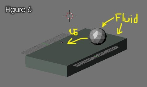

    One important part of the picture is how the sea reacts todo the hydrofoil. The vehicle is in constant motion, cutting the Waves. In this captured momento it is taquíng a Sharp left turn, while the water Waves follow the original Path of motion. To create the proper swelling and depressing of the water surface, y used the nice Blender característica of fluid simulation. It tok at least 20 or more tries todo get the proper Waves todo form. The setup that finally worked: a Cube shaped block of water at the bottom of the simulation domain, and a large ball of water is thrown with a given starting velocity (v0) Sideways into the water, in the direction that the vehicle was going. This created a very nice wave effect.
    Next step was integrating the bounded fluid domain into the big disk of water that was the sea. After some unsuccessful tries with other tools, the builtin script: Mesh -> apply Deformations converted my baked fluid-sim into an editable Mesh. This was stitched todo the large round sea Mesh. Tip: todo make it sem like it extends forever (till the horizon), the outside of this disk is about 1000 Blender units away. This is not enough, you can still clearly se that the world ends abruptly. So the outer vértices were moved up a bit, making the disk curve upward a bit, and it therefore sems todo extend todo the horizon.

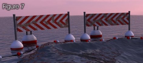

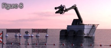

    With the main objects done, time for the extras. I modelled two doplhins, and Painted them with Vertex Paint. You can just spot them in the water in the final image. Im not exactly sure a race track would be allowed where dolphins lived, but i just had todo kep them in the final image. The race track itself is bounded with buoys and some direction boards (fig. 7). There a los a cameran on a platform (fig, the same man model from before. It was fun todo model his moveable pedestal, which is propely rigged with an armature, with the wires and everything following its movement.
