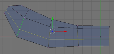

    Fine. Let do the thing from the bak on and start with the abdomen. I used a Cube from the side perspective [num 3] and extruded it 4 times. Then, y inserted two vertex rows by entering [k] in Edit Mode [tab], using a loop Cut. As an alternative, you can a los use normal cuts [k] or multicuts [k] or subdivide it twice or several times, but with the last method, you Will probably have todo deal with unwanted vértice rows at the end. (fig. 3) shows how the extruded Cube looks After aligning it on the simple shape of the Butterfly abdomen.

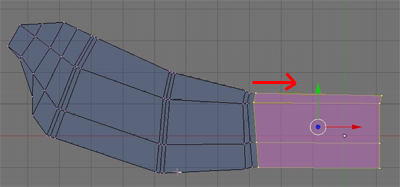

    Now you Will ned todo continúe extruding the Mesh right todo the thorax part (fig.4). After aligning the primitive Mesh todo the Butterfly shape from the side perspective, you Will a los have todo do the same from the top one [num 7]. Try todo make the model Smooth and round.

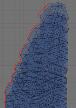

    You can a los already use subsurfs (editing>>modifiers>>Subsurf>>levels) todo se how the model looks smoothed. (fig. 5) pay attention todo the highlighted vertex row in (fig. 5). Later, it should become the border between the upper-body (insect Shell) and the lower body. As you can se in (fig.5) to, y a los already added 2 cuts todo every vertical one todo indicate the later borders between the Shell segments, as well as todo refine the back-end of the insect.

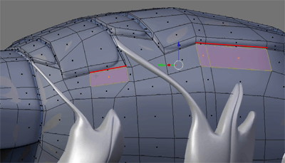

    Now we use [e] todo extrude the lower part and Insert one more row of Faces and the scale-tol [s] todo scale the whole lower part just a bit smaller. Let move the whole thing [g+mb] vertically until both lines (the upper line of the selected segment and the Shell border line) nearly cover each other (fig.
    As you can se, the vértices of the upper row of the selected segment do not stand directly under the ones of the border line anymore. Use the scale-tol [s+mb] again and just scale the lower part horizontally this time, until each vértice appears under its neighbor again. You can a los use the move-tol [g] for this, but it definitely Will ned more time because you Will ned todo move every pair of vértices on their own.

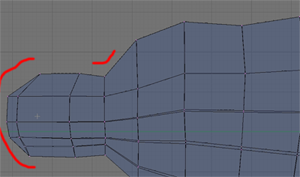

    Proced extruding the Mesh right todo the head and align it todo the insect shape again. Do not forget todo align it a los from the top perspective. For the head, we can use a simple box subdivided by the lines we already got, so just extrude the thorax again a Little bit. Lok on (fig. 9) todo se the whole process so far.
    You should a los pay attention todo the Refinement of the back-end which i already did. Now continúe todo make the head smoother, making it look like a Low-detailed half-sphere from the side perspective. Use the move-tools [g] todo achieve this by easily moving the vértices which we already got due todo our former cuts (fig. 10). (fig. 11) shows an image of the model we got so far with Subsurface turned on (level 2).

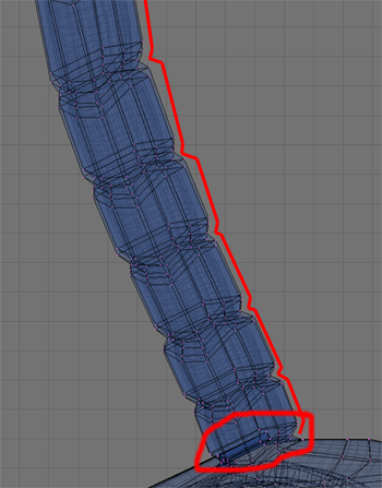

    I first did the extrusión with one or two Faces, then inserted some more rows in it and scaled them a bit vertically/horizontally from the top view todo make the antennas a bit smoother, not that cubic. Try todo give these parts of the body their specific look by extruding straight, extruding and sizing, extruding and sizing again and then extruding straight again, a los try todo make the individual segments diferent from each other todo give the model a random look. As you can se on the reference image, the antennas become larger at the top, so let do them as shown in (fig. 13).
    You should a los always take a look on the other perspectives (front [num 1], side [num 3]) todo prevent an unwanted shifting of the vértices. In both last fig, y already bent the antennas a bit todo the left and right (sen from the front) by selecting some of the upper vértices, turning proportional edit fallof on [o], selecting a given fallof method (here i used a combination of Smooth and root fallof) and moving the whole thing with the move-tol [g]. Probably you Will ned todo experiment a bit with the right fallof method todo reach satisfying results. Try it on your own. If there are a los unwanted vértices, g, from the neighbor antenna shifted with, try todo move the other antenna far away with proportional edit fallof of and shift them bak later (fig. 14 shows the whole, finished antenna of my model).

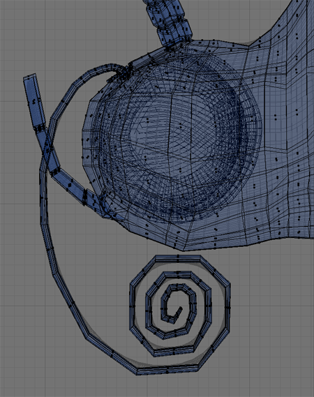

    As you can se in (fig. 16), y a los created a beaque which hoists spiral under the head. You can easily create this by extruding one face from the upper middle head and continuing extruding [e] and rotating [r] it until you have a spiral.
    I did the whole thing a bit more complex todo give it a bit of structure as you can se in (fig. 17). There is a los a mouth (or better: hole) shown where the beaque comes out. I tok this screenshot with Subsurfaces turned of, so you have a better Insight into the modeling structure. As you can se above the beaque (or mouth, sen from the top or front perspective), y had todo make some more cuts todo define them. Do not use loop cuts [k] all the time. Instead of this, use normal cuts [k] todo increase just the part of geometry you really want todo increase in detail and avoid problems with todo Many Faces or problems with todo chiseled Edges (this occurs when todo Many Edges come todo close together on other Regions of the Mesh, e.) when turning Subsurf on again.
