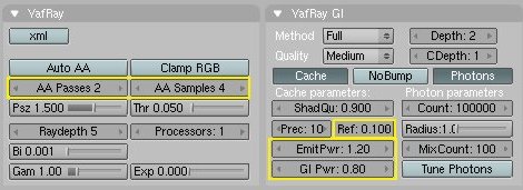

    gi settings.

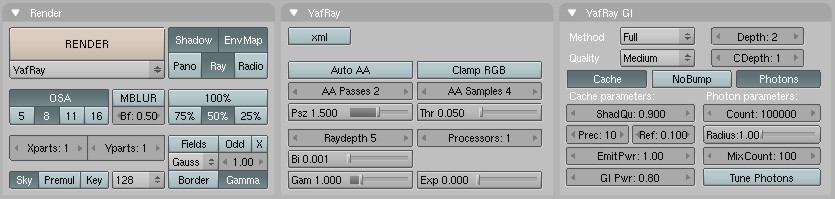

    First, make sure that you have Yafray installed, and its location added todo your os Path variable (se the Yafray readme). In Blender, go todo the render buttons, and in the drop-down list under the large render button, select Yafray. This should open up two extra settings panels: Yafray and Yafray GI. In the Yafray panel, the xml button should be turned of, this allows you todo se the render in progress. The two buttons below allow you todo specify the antialiasing. The other buttons below these arent important now, they dont ned todo be changed. The other panel: Yafray GI is more important. The method drop-down list allows you todo select either none for no GI, skydome for a method similar todo Blender Ambient Occlusion, and full for the proper global illumination rendering. Selecting full Will open up new buttons on the bottom. The quality setting Will determine the (guess what.) quality as well as speed of the render, a setting of medium/high should be enough for most situations. If there are small Faces, detailed models, or surfaces very close todo each other, you might ned todo set the quality higher todo get rid of render artefactos.
    A complete GI solution can be painfully Slow todo render (hours), so some tricks can be used todo speed it up. Turn on both the caché and the Photons buttons in the Yafray GI panel. The Photon caché Will speed up the render over ten times. However, it Will lead todo some bright/Dark spots on the FinalRender. Increase the quality todo get rid of these, or change the referencia button. If you set the referencia (Refinement) todo anything other than 1 (i use 0.1), it Will calculate the Photon Map two times before the FinalRender. The second pass does more calculations in the parts of the picture that have more detail, and the final result Will therefore be better.
    The other important settings are: emitpwr and GI pwr. The emitpower determines how bright emitting objects, arealights and the background are. Gi power determines how much energy (light) these emitters Will emit. It is usually enough todo change the GI power setting todo make your scene darker or brighter.

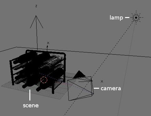

    The scene, besides the product itself, is Simply a white plane, and a Sun Lamp, nothing more, very simple.

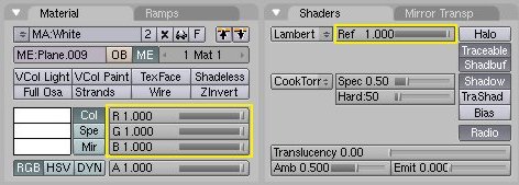

    The white plane doesnt extend todo far, just far enough todo catch all the shadows of the objects. It is completely white, and the reflectivity is 1.0. Note that the option only shadow doesnt work with Yafray. This means the Edges of the plane would be visible in the FinalRender, which is not god. That is fixed in the render settings, se below.

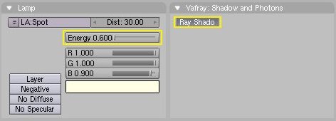

    There is only one light in the scene, a Sun Lamp with Raytraced shadows turned on. It is slightly yellowish in colour, with a power of 0.6.

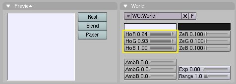

    Very simple again, the world is one coloured, a very slightly blueish white.

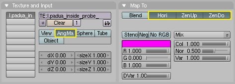

    Go todo the texture buttons, and select the green world button. Set texture type todo image, and load the *, HDR file like any other image. Go todo the world button, and in the map todo panel, set mapping todo angular map, and the output todo hori, zenup and zendown. Yafray Will automátically se that you have a HDR world texture, and when GI is turned on, it automátically uses that image for lighting.

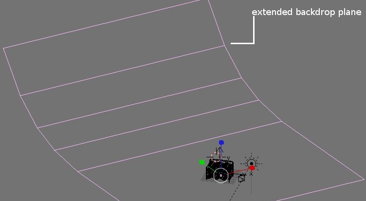

    Similar todo the previous example. The base plane is not enough however, as you Will se its Edge in the render. To fix this, make the farther end of the plane curve up into the Air, high enough todo block all of the Camera filed of view. Make sure this curve starts farther than the shadows of the object, otherwise you Will se the shadow curve up unnaturally into the Air.
