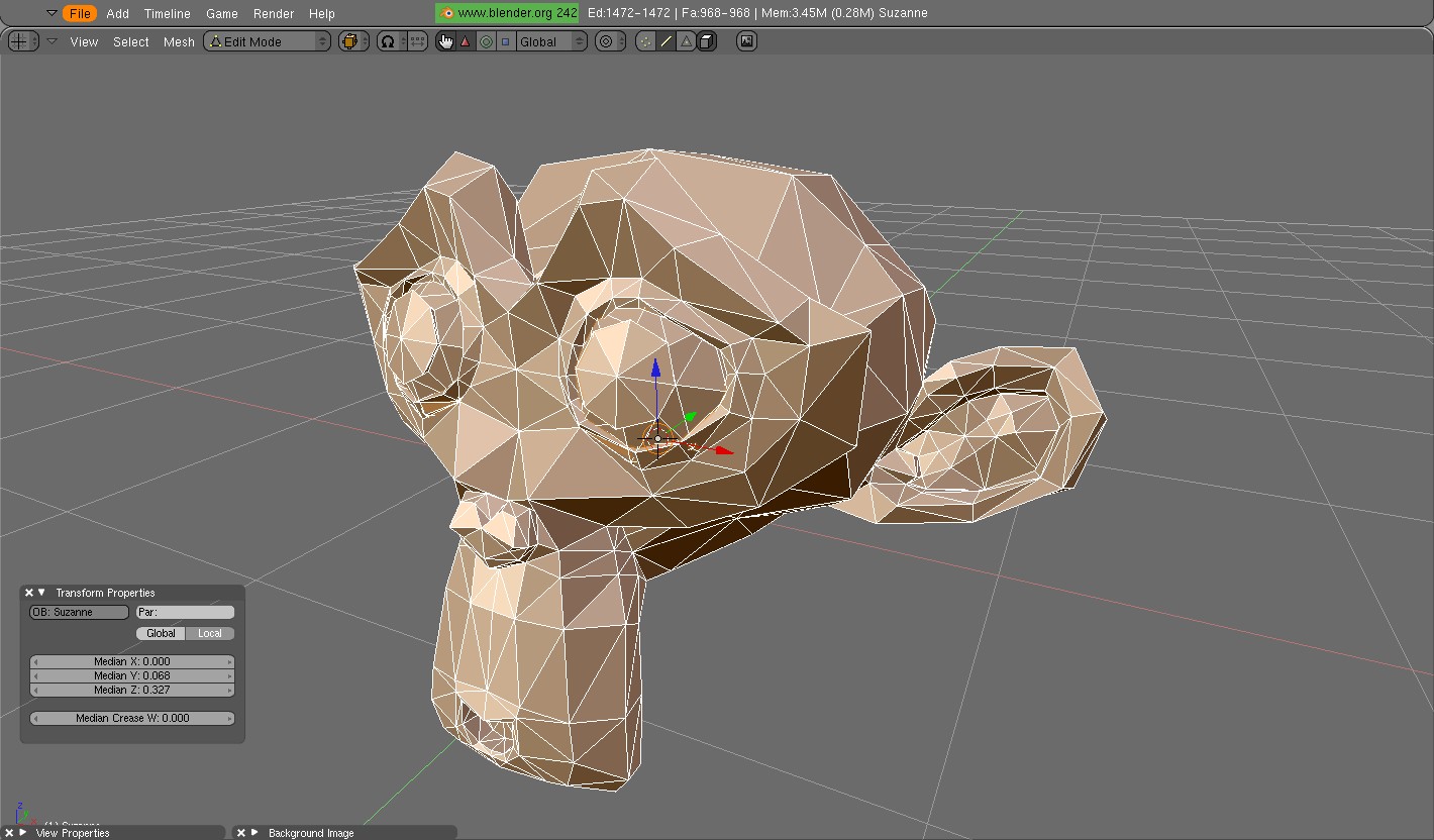

(Campbell Barton) 2006/09/20 04:43:09 cest]. Added files: Blender/release/scripts mesh_solidify, py. Log:
Update and add a new script -.
Makes the Mesh solid by creating a second skin of a set width.
Works with UV and vertex col but not weights at the moment.
https://www.foro3d.com/images/upload...2006/09/51.jpg
https://foro3d.com/attachment.php?attachmentid=36591
