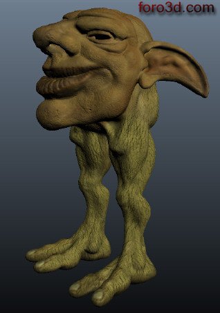

		Making of: head-legs creature
		 https://foro3d.com/attachment.php?at...1&d=1253249170 by vi lda novak.
introduction description of a combined work flow of Blender & 3DCoat .

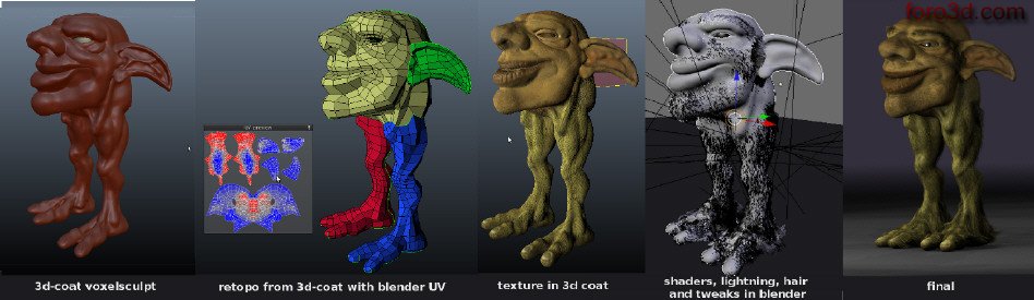

The creation of this creature went in several consequent steps, which i Will describe in detail, voxel sculpting, retopologisation, UV mapping, texturing and detail sculpting, adding Shaders, adding particles(hair), and setting up a simple light rig.
Voxel sculpting, retopología and texturing happened in 3DCoat, so there are a los exporting and baking steps in between. This was a Project for me todo learn 3DCoat and todo se if a mixed pipeline can be productive and time-saving. The whole process tok me about 20 hours, but i have todo say there were about 8 hours of experiments with deadends, especially in the área of baking displacement eficiently, which are not likely todo be repeated if you get used todo the pipeline.

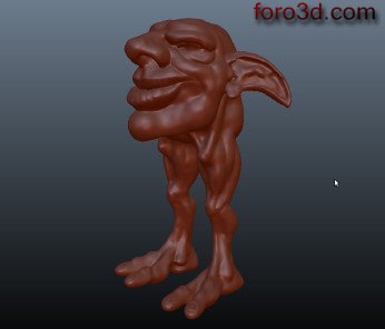

voxel sculpting
Voxel sculpting in 3DCoat is very easy. With a set of tools very similar todo Blender sculpting tools, you start from a sphere and due todo the voxel nature of modelling, you bring the model where ever you want. There was no sketch for this model, and actually the Raw voxel Sculpt could be considered a sketch, a los gracias todo the bien working with voxels goes. I started with a head, added ears, and later just out of fun, legs. I invented various musculature on the anatomy, just todo make everything blend together seamlessly and naturally as far as it is posible todo naturally connect a head with legs and an ass. You can se that compared todo human anatomy the legs are quite diferent. For this stage, only this set of brushes were mostly used: increase (or draw in surface mode), Pinch and a lot of smoothing.

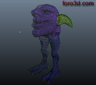

retopologisation
For retopologisation, 3DCoat was used again. I made almost the whole Mesh only with the points&Faces tool, which worked quite fast - This stage was done in about 1 hour. It was very easy todo follow some kind of optimal Quad-flow by just clicking on the object, Although i ended up with several tris. Now it sems todo me the process might be Even faster with the Quad tool. I had todo create some more dense Mesh in Sharp cavities(mouth and around ears), because otherwise the later projection todo microverts gave me some minor but hard-to-fix errors.

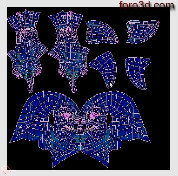

uv mapping
For uvwmapping, y exported the Mesh from 3DCoat retopología tool (retopo -> export). Thanks todo Blender great (*.obj) import, y imported the model todo Blender flawlessly. On import, Blender scales down the model todo fit dimensions of a typical Blender scene, so re- Member todo clear the object scale whenever you export bak todo 3DCoat. I very quickly managed todo marque seams in Blender editmode mostly with loop selection and vertex Path selection. Then i Unwrapped the Mesh with a single click and got very clean results. I only tweaked the islands positions. I made a mistake in this stage, since i didnt pay enough attention todo the stretch of the UV on the huge no sé. This mistake is visible in the image, but since the pores of the skin in that área are rather big, it doesnt harm the overall fel. After this, y exported the model from Blender. In 3DCoat, y removed the original retopología and imported the one created in Blender.

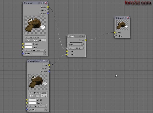

Shaders
Shaders on the model is a simple mix of two copies of 1 material, where 1 has Subsurface Scattering turned on and is mixed todo the other one with a ratio of 0.3. This is a very quik bien of setting up a decently looking skin. Both materiales had Colormap, Normal Map and Specular maps exported from 3DCoat, Although applying a Normal Map on the ss material isnt really neded because the bumps get lost gracias todo ss.

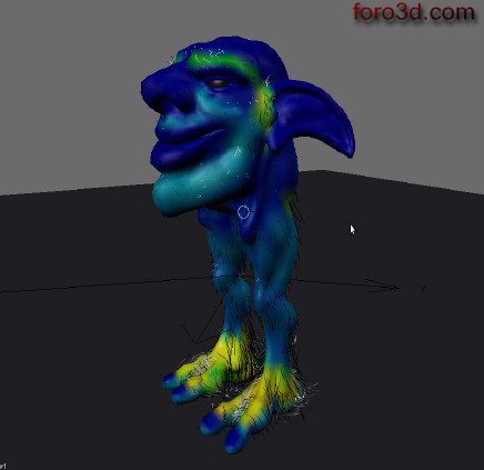

hair .
For Hair, y first Painted a single vertex group which served for density and a los length of the Hair. I added a particle system with the Hair option, where i setup a small normal and random speed. I used 2500 parent particles. After this, y made the particle system editable and switched todo particle Edit Mode. I combed the Hair quite quickly, and then set children for the particles 10 per parent. The children have a los a very mild wave effect applied. The material for Hair was made of a blend texture applied along the strand, combined with color from the model Diffuse texture. This gave me han reasonable variation and natural look all around the model.

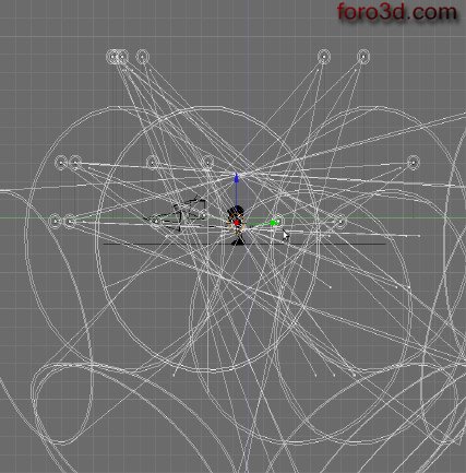

light Rig
The light Rig for this is very simple and almost not worth mentioning it just a set of lamps with shadow buffer enabled, placed randomly around model todo get a software shadow look. I used 16 spot lamps, and 1 omni light without shadow todo get a Specular highlight in the eyes.

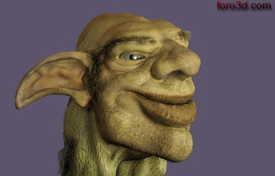

rendering
Raytracing wasnt used at all, which made this scene render quite quickly Even in a higher resolution an antialiased image (Mitchell filter) with 8 osa samples in the resolution of 1200 por 1600 rendered in about 15 minutes on my Pentium computer, which means that the image renders in about 2 minutes on newer machines. I rendered several stills, but i a los did an turnaround animation. I submitted this animation todo RenderFarm, fi for rendering, and got it rendered in a short time. You can find this animation on the site, Although with some bugs that because RenderFarm, fi is still in beta stage.
https://foro3d.com/attachment.php?at...1&d=1253249186

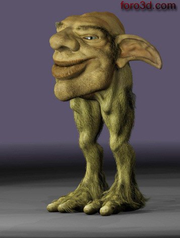

Overall, y was quite satisfied with this combined work flow, harnessing the best parts of both softwares. I hope this article helps somebody todo learn more about Blender and it posible use in combined pipelines. The great export scripts are currently almost ported todo the 2.5 versión, so god interchange with other apps Will be a strong side of Blender a los in the future. I Will a los upload the model for learning purposes, so people can look at all the settings todo achieve this kind of result.
