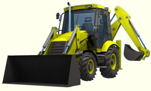

Introduction i have ben working on this model for some time now and rather than repeating the usual step by step tutoriales, y have decided instead todo write a brief article. The article Will detail the process and a few of the techniques used todo get from the first idea todo construction of a complex Mechanical model that could be animated, todo the finished excavator.
As with any Project the first stage is planning, and as this was a learning exercise todo get todo grips with Blender animation tools, y had todo choose a machine that had a lot of moving parts. The excavator fit the Bill perfectly.
Now knowing what i was going todo model, it was time todo go of and find reference materiales. A set of plans would be useful, but unfortunately none were available on the usual plan repositories. However, the manufacturer did have some reasonable side, front and rear views in their pdf literature. They didnt exactly scale th rouge from one view todo the next, but a Little adjustment in Gimp got them near enough todo be used.

With a few more details added, it was time todo se how this model loked in a render. Basic materiales were added for the paintworque and a highly reflective material added todo the hydraulic pistón todo simulate the Ground Chrome material. The model was then positioned on a plane which was curved at the bak todo simulate a Studio bak drop. Two área lights were added together with a light behind and above the model reelative todo the Camera.
https://www.foro3d.com/extras/tutori...l-model/11.jpg
In order for a reflective material todo look god it must have something todo reflect.
A basic reflection map was created by placing a UV sphere inside a box together with a few props todo simulate a Studio flash brolly. The UV sphere was set todo the máximum reflection and an image renderer of the sphere. This was then used as an angle map in Blender world settings.
https://www.foro3d.com/extras/tutori...l-model/12.jpg
The end result was a Fairly convincing image of an excavator, though, given time, the image could be improved considerably. This isnt the end of the excavator Project, i now ned todo UV Unwrap the model and add some realistic textures, then set the model in a construction scene. All that, however, is for a future date and i Will mensaje further información here when it is completed. I hope you have found this run-th rouge of the Project useful.
