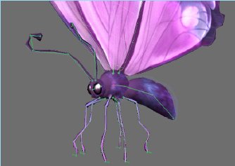

De-mystifying rigs
de-mystifying rigs.
https://foro3d.com/attachment.php?at...1&d=1245950003
For years i have avoided anything beyond very simple rigging. In fact in my efort todo avoid learning what semed like an impossibly complicated skill, y ended up becoming the que of the incredibly simple rig. My rigs had no constraints, no bone shapes and as few Bones as posible. Then again, y was only posing characters for still images, there was no animating controls neded.
Trying todo study and learn from the variety of free rigs available only added todo my confusión. They were composed of so Many Bones, constraints and ODD bone shapes, y never could make heads or tails of just what was going or how todo build one of my own.
But After serious study of some great resources, y realiced that the seming Chaos of rigs is actually not that complicated. Well ok, yes it is still complicated, but there is a logic, flow and Even a pattern todo it.
When you break it down todo the most basic idea, a god working Rig has thre main components.
