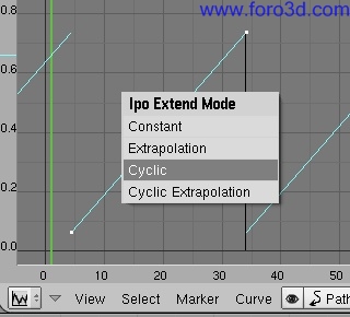

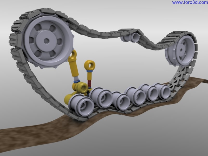

Well, enough said, lets get on with the Project. The main criteria are:

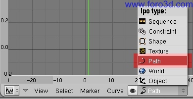

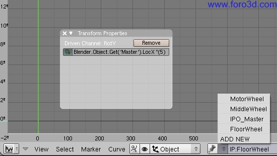

- doing animations with only one ipo (the one ipo research attitude : oira), lol, this name just make me laugh myself.
- when not posible, than as few as posible ipo research attitude : afapira)
- in the oira or afapira serial, we are starting with oing the whels of a vehicle staying on the flor (Mesh) with constraints doing a caterpillar software track, with dynamic inertia no addition of Python scripting, y am not yet a experienced in it (pydrivers are allowed)
Use modifiers and constraints from Blender 2.48a.

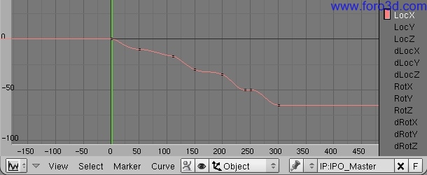

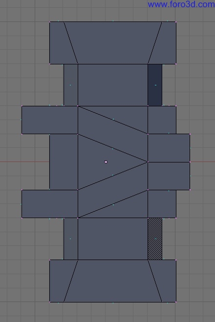

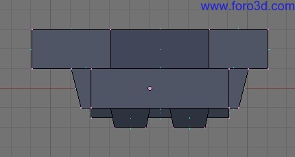

1. Layer 1 : the flor
Open a new Blender file, deleete all objects, select only layer 1 (1), switch todo top view (Numpad 7), add a Mesh plane (space, Mesh, plane), in Edit Mode (tab) select (RMB, shift+RMB) and deleete (x, 1) the 2 upper vértices, select the remaining Edge (a) scale it 20x (s, 20, enter), subdivide it 21x (w, 2, number of cuts :21).
https://www.foro3d.com/extras/tutori...erpillar/1.jpg
Select the vértices on the positive part of the x axis (b, LMB+mousemove), and hide them (h).
https://www.foro3d.com/extras/tutori...erpillar/2.jpg

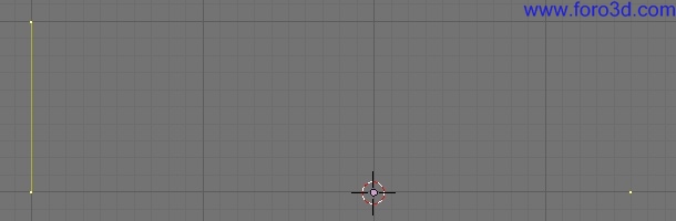

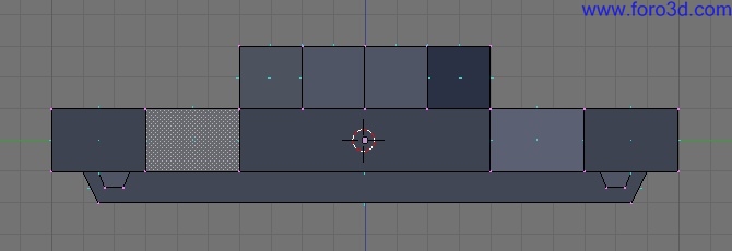

Switch todo front view (Numpad 1) select the two middle vértices, switch todo the proportional edit tool (o), select random fallof, move the vértices 1bu along the z axis, having all the vértices in the select circle (g, z, mousewhel).
https://www.foro3d.com/extras/tutori...erpillar/3.jpg
https://www.foro3d.com/extras/tutori...erpillar/4.jpg

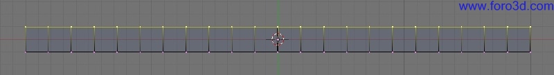

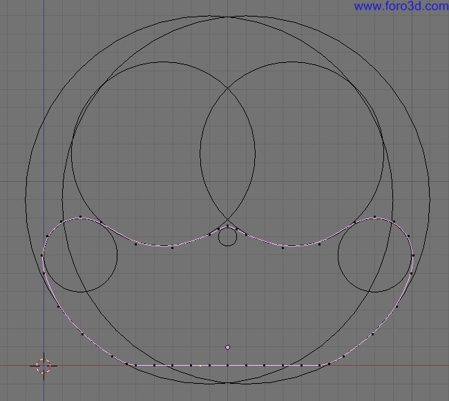

Switch todo top view (Numpad 7), reveal the invisible vértices (Alt+h), select all the vértices (a, a), extrude 2bu along the y axis (e, 1 y, 2, enter).
https://www.foro3d.com/extras/tutori...erpillar/5.jpg
Select all the vértices (a, a), recalculate normals outside (Control + N), swtich todo object mode (tab), add a modifier Subsurf (Control + 2).

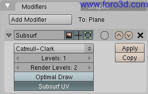

Rename the plane in flor and make it smooth.
https://www.foro3d.com/extras/tutori...mg-00350tm.jpg

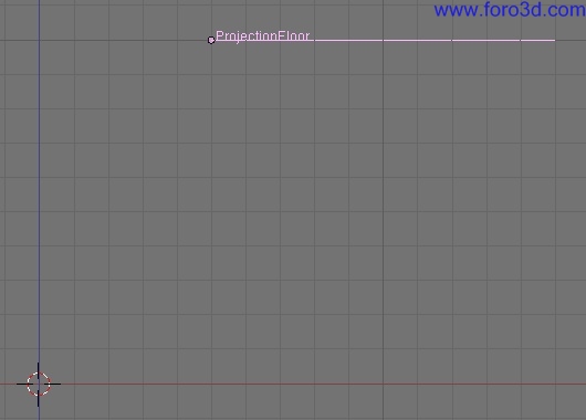

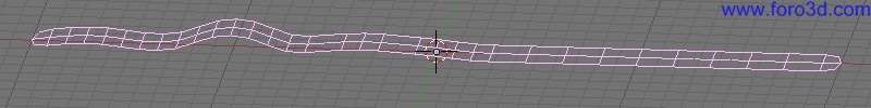

2. Layer 2 : the projections
Select only layer 2 (2), switch todo top view, add a Mesh plane and modify it todo obtain 10 Edges from 1bu (blender unit) on a straight line, place it on x=5, y=0, z=10, give it the name projectionflor and watch of the center on the object.
https://www.foro3d.com/extras/tutori...img-00450t.jpg

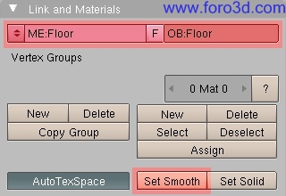

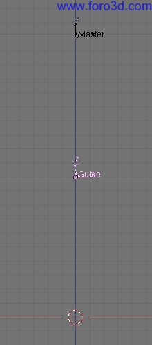

In Edit Mode, go todo the panel enlace and material (f9), add a vertex group (new), name it pr1, select only the first vertex on the left, press assing. Add a vertex group (new), name it pr1b, assing todo this group only the second vertex, then make the same for pr2, pr2b, pr3, pr3b. Pr6.
https://www.foro3d.com/extras/tutori...mg-00500tm.jpg

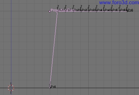

3. Layer 3 : the hooks
Keping layer 2 active, select layer 3 (shift+3), switch todo front view, add an Empty (space, empty), name it pr1, place it exactly on the same place as the first vertex from projectionflor, using the Control key todo Snap todo the grid (g, Control + mousemove). If the Empty doesnt have his z axis pointing up, chek in the user preferencias that the button aligned todo view is not enabled.
https://www.foro3d.com/extras/tutori...mg-00550tm.jpg

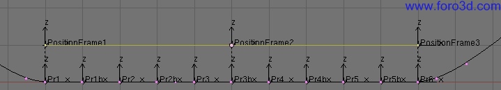

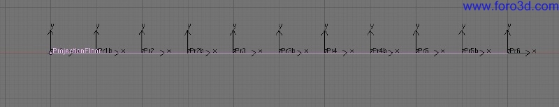

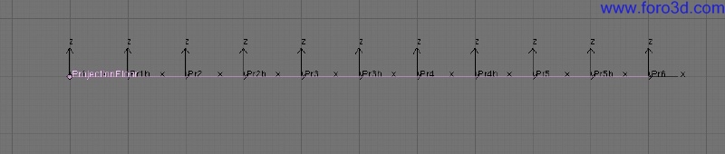

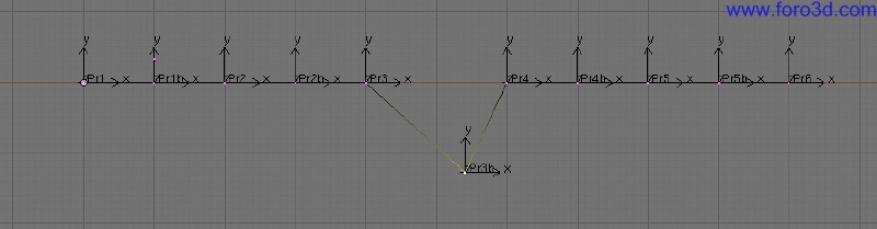

Add an empty, Snap it todo the grid on the same position as the second vertex, name it pr1b. Go on with pr2, pr2b. Pr6. Verify in top view that the position of the empties is correct on the y axis todo. In the panel draw (f7), show the name of the diferent objects on layers 2 and 3.
https://www.foro3d.com/extras/tutori...mg-00600t1.jpg
https://www.foro3d.com/extras/tutori...img-00650t.jpg
https://www.foro3d.com/extras/tutori...mg-00600t2.jpg

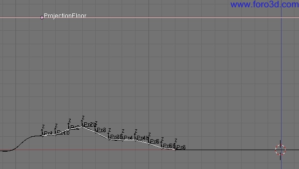

Select the Mesh projectionflor (RMB), switch todo Edit Mode (tab), select only the first vertex on the left (RMB). Staying in Edit Mode, select the corresponding Empty pr1 (Control + RMB) and create a hok on the vertex (Control + h, 2).
https://www.foro3d.com/extras/tutori...img-00700t.jpg
Then select the second vertex (RMB) and the second Empty (Control + RMB), create the hok (Control + h, 2), and so on todo the last empty. Now when you are finished, if you select one vertex and move it (g+mousemove), the corresponding Empty Will follow.
https://www.foro3d.com/extras/tutori...img-00750t.jpg

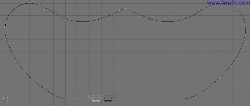

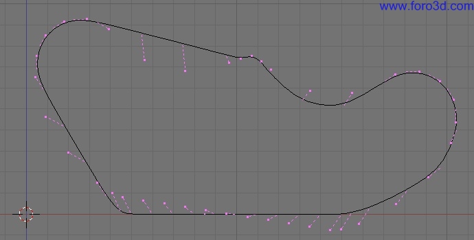

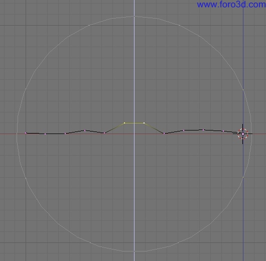

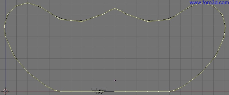

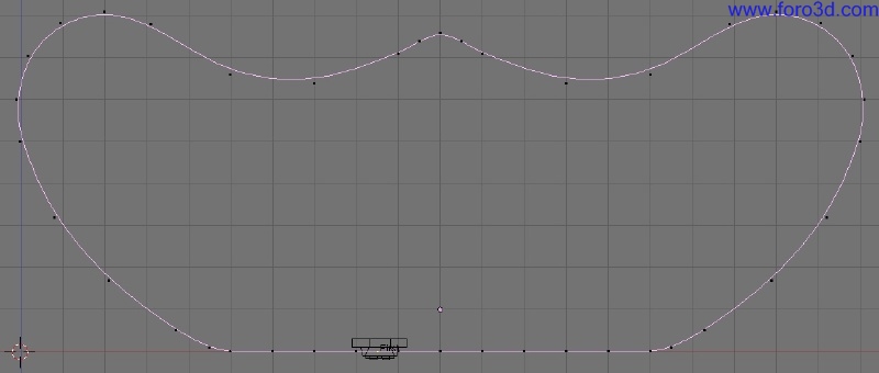

4. Layer 4 : the Path

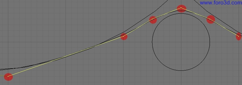

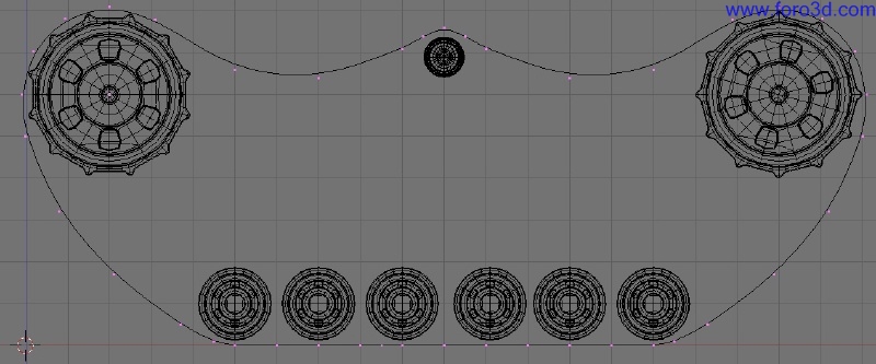

Show only the layer 4 (4), front view (numpad1) add some curves Bézier as landmarks todo position the curve Nurbs circle which Will be the Path of the caterpillar track. Because we dont ned 3d curves, it is necessary todo turn the curves around the x axis. Show the panel transform properties set the rotation for Rotx. And dont forget todo give names todo all your objects.
https://www.foro3d.com/extras/tutori...g-00900t1m.jpg
https://www.foro3d.com/extras/tutori...mg-00900t2.jpg
Note for the lazy people (like me, sometimes) : try todo Snap most of the control points from the Path pathcaterpillar on the grid (zoom around a bit if necessary) because son you Will have todo align Bones and empties on every control point of the Path. So it is easy todo do it with an extreme precisión where every object has his place on the grid.
https://www.foro3d.com/extras/tutori...g-00950t1m.jpg
Note for everyone (like me, sometimes) : ensure that you have a round length from your Path when youve finished designing it. For example, 50, because the caterpillar track Will be easier todo configure with (for example) 50 links, having every 1bu width.
https://www.foro3d.com/extras/tutori...g-00950t2m.jpg

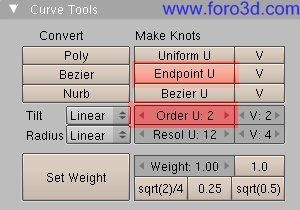

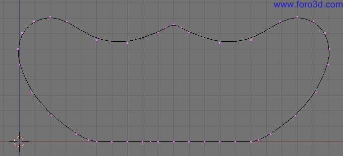

Select all the vértices, go todo the panel curve tools (f9 when the curve is in Edit Mode), set the order u todo 3, and attribute todo all the vértices a weight of 1.
https://www.foro3d.com/extras/tutori...g-00950t3m.jpg
Note for the pressed people (like me, sometimes) : it is important todo draw the curve pathcaterpillar like a slak rope, because when the caterpillar moves, the track Will tighten. But remember, its not elastic, so the length must be kept constant.
The Path must look like a slak rope now because it Will look like a tight rope son.
https://www.foro3d.com/extras/tutori...img-01000t.jpg
https://www.foro3d.com/extras/tutori...img-01050t.jpg

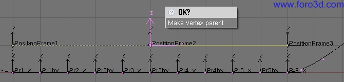

5. Layer 5 : the constraints
We are going todo configure a lot of constrained empties. This system Will help us todo position the Stel frame of the vehicle, and todo deform the future armature which Will itself control the curve pathcaterpillar.

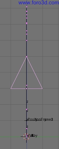

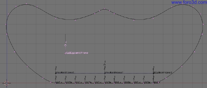

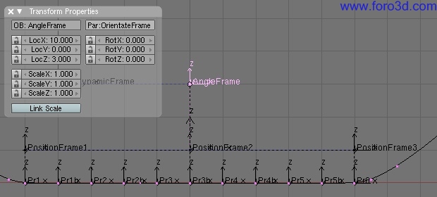

Show layer 3, 4 and 5 (3, shift+4, shift+5), add an empty, name it positionframe1, set its size as 0.5 in the panel enlaces and material, give it the Empty pr1 as parent (RMB on positionframe1, shift+RMB on pr1, Control +, enter), and move it 1bu above pr1. Do the same with positionframe2 (parent = pr3b), and positionframe3 (parent = pr6).
https://www.foro3d.com/extras/tutori...mg-01100t1.jpg
https://www.foro3d.com/extras/tutori...mg-01100t3.jpg

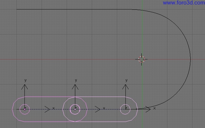

Add a Mesh plane, name it averageframe, modify it todo obtain 3 vértices on a straight line, with every vertex on the position of positionframe1, positionframe2 and positionframe3. Hok each vertex todo the corresponding empty.
https://www.foro3d.com/extras/tutori...mg-01150t1.jpg
https://www.foro3d.com/extras/tutori...mg-01150t2.jpg

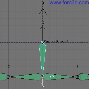

Switch todo object mode, add an empty, name it orientateframe, place it on positionframe2, select the Empty orientateframe (RMB) and the Mesh averageframe (shift+RMB), switch todo Edit Mode (tab), select all the 3 vértices (a), and define the vértices as parent from the Empty (Control +, enter).
https://www.foro3d.com/extras/tutori...img-01200t.jpg

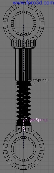

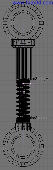

Switch todo side view (Numpad 3), add a Mesh plane, name it softframe, go in Edit Mode (tab), and rotate the plane around the y axis (r y, 90, enter). Select only the 2 upper vértices, merge them (w, 5, 3, enter), select all (a, a), subdivide (w, 1), and move all 1bu up (g, z, 1, enter). Set the parameters in the panel software body (f7, f7).
https://www.foro3d.com/extras/tutori...mg-01350t1.jpg
https://www.foro3d.com/extras/tutori...g-01350t2m.jpg
https://www.foro3d.com/extras/tutori...mg-01400t1.jpg
https://www.foro3d.com/extras/tutori...g-01400t2m.jpghttps://www.foro3d.com/extras/tutori...img-01450t.jpg
This method is not mine, you can read about it here. http://www.blendernation.com/2008/02...era-shaquíng/
And you Will find the full description herer http://blenderartists.org, http://blenderartists.org/forum/showthread.php?t=116699
Gracias you yoyofargo.

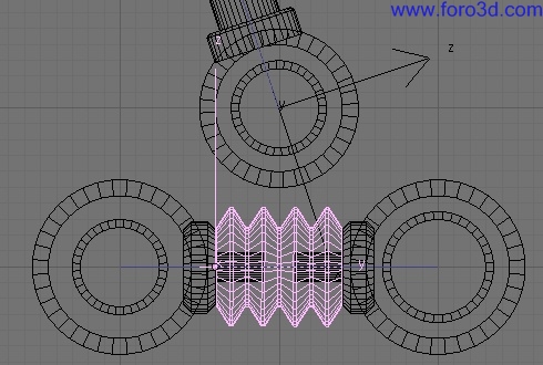

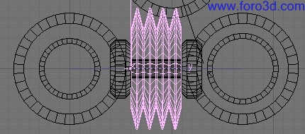

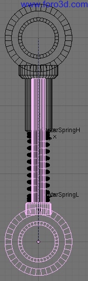

Add an Empty at the origin from softframe, name it softdynamicframe, and give it the 3 central vértices from the Mesh as parent.
https://www.foro3d.com/extras/tutori...img-01500t.jpg
https://www.foro3d.com/extras/tutori...img-01550t.jpg

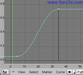

So, when the Softbody Will move, the Empty softdynamicframe Will receive an angle of the movement. This angle Will be copied todo move parts from the future armature.

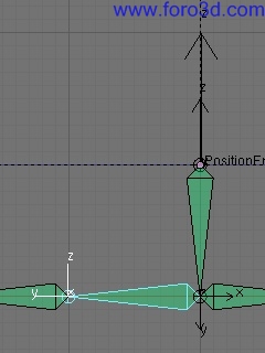

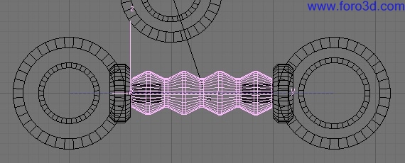

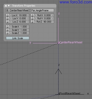

Hey, Grab a drink, its not finished yet. Add an Empty centermidwhel, child of angleframe, add an Empty IK Targetmidleft and an Empty IK Targetmidright both child of centermidwhel. Iktargetmidleft and IK Targetmidright must be placed on the corresponding vértices from pathcaterpillar.
https://www.foro3d.com/extras/tutori...img-01650t.jpg

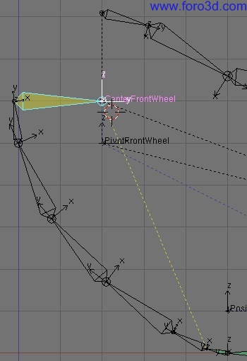

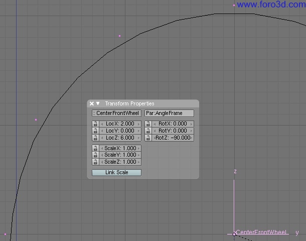

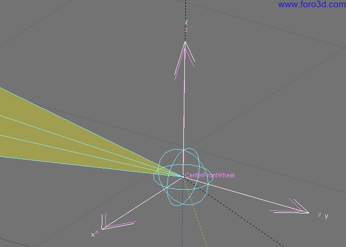

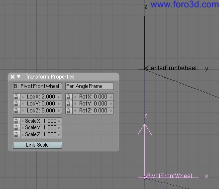

Add an Empty centerfrontwhel, child of angleframe. Rotate it -90 grados around z axis (r, z, -90, enter). This special orientation Will be useful for a future IK constraint.
https://www.foro3d.com/extras/tutori...img-01700t.jpg
This Empty Will have todo turn in the other bien round of angleframe. To do the magical trick, we ned another Empty pivotfrontwhel, child of angleframe, and a constraint transformation on pivotfrontwhel. The target object of the constraint is softdynamicframe.
https://www.foro3d.com/extras/tutori...mg-01750t1.jpghttps://www.foro3d.com/extras/tutori...g-01750t2m.jpg
Centerfrontwhel Will receive a copy rotation constraint from pivotfrontwhel.
https://www.foro3d.com/extras/tutori...mg-01800tm.jpg
Now if you rotate softdynamicframe, you should be able todo se something like this.
https://www.foro3d.com/extras/tutori...img-01850t.jpg

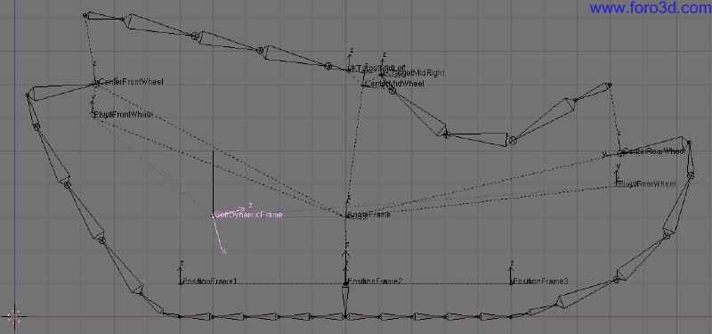

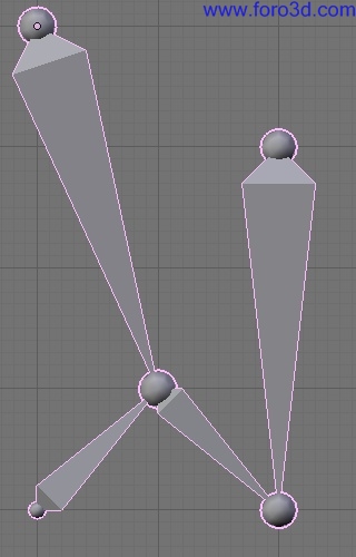

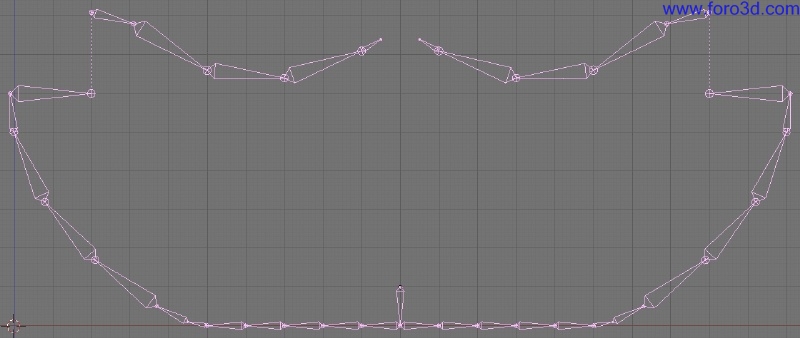

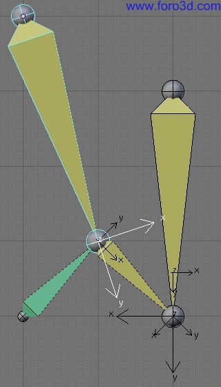

6. Layer 5 : the armature
Add an armature on layer 6. Remember that each bone starts and ends on a vertex from the curve pathcaterpillar (you might se some exceptions on the picture below). Origin of the armature is the position of orientateframe, and parent of the armature is orientateframe todo.
https://www.foro3d.com/extras/tutori...img-02000t.jpg
When the armature is designed, in Edit Mode select all the Bones (a) and recalculate bone roll angles (Control + N, 1).

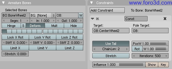

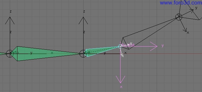

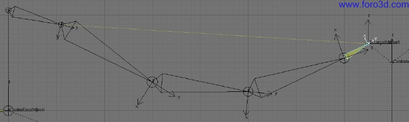

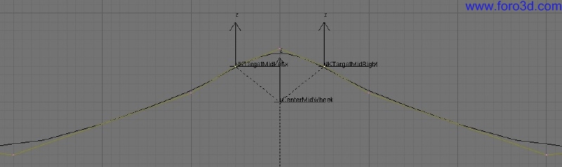

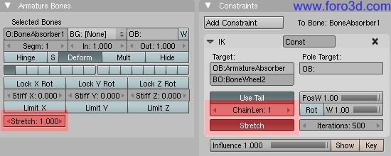

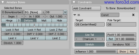

Its time todo add IK constraints. Armature is in object mode. Select the Empty centerfrontwhel (RMB), select the armature (shift+RMB), switch armature todo pose mode (Control + tab), select the bone which already pointing on the empty, add the constraint todo active object (shift+i, 1).
https://www.foro3d.com/extras/tutori...mg-02050t1.jpghttps://www.foro3d.com/extras/tutori...g-02050t2m.jpg
Dont forget todo disable the stretch button, we ned a constant length. The option root lets the bone follow the rotation of the target, and you, Lucky people, have already set the orientation of the target centerfrontwhel in part 5, didnt you?
https://www.foro3d.com/extras/tutori...mg-02100t1.jpghttps://www.foro3d.com/extras/tutori...g-02100t2m.jpg
What else? The IK for the middle whel.
https://www.foro3d.com/extras/tutori...mg-02150t1.jpghttps://www.foro3d.com/extras/tutori...mg-02150t2.jpg

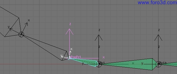

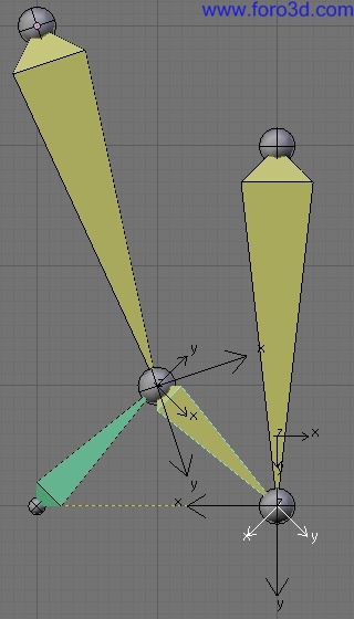

Have you twigged? Vaya, by the way, you must add in layer 3 an Empty prepr1, child of pr1, and a postpr6, child of pr6.
https://www.foro3d.com/extras/tutori...mg-02300t1.jpg
https://www.foro3d.com/extras/tutori...mg-02300t2.jpg
https://www.foro3d.com/extras/tutori...mg-02350t1.jpghttps://www.foro3d.com/extras/tutori...mg-02350t2.jpg
https://www.foro3d.com/extras/tutori...mg-02400t1.jpghttps://www.foro3d.com/extras/tutori...mg-02400t2.jpg

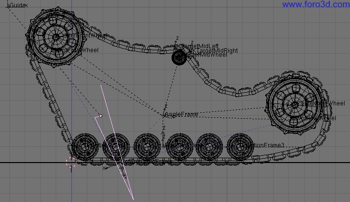

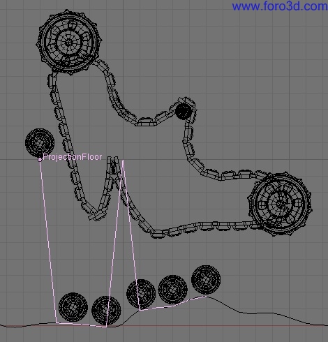

Show the layers 5 and 6, rotate the Empty softdynamicframe (+ and -90°), what do you se? Armature is deformed but not stretched? Goal reached. Well, in fact not completely. The IK for the middle whel is only efective when it stretches a Little bit.
https://www.foro3d.com/extras/tutori...img-02450t.jpg
Note for the experts (like me, maybe one day) : if you find a better bien todo use the IK constraint, without any stretching, with a full constant length for the complete chain, por favor share some tips as how you achieved it.

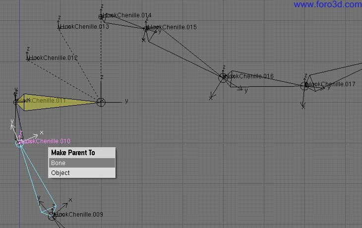

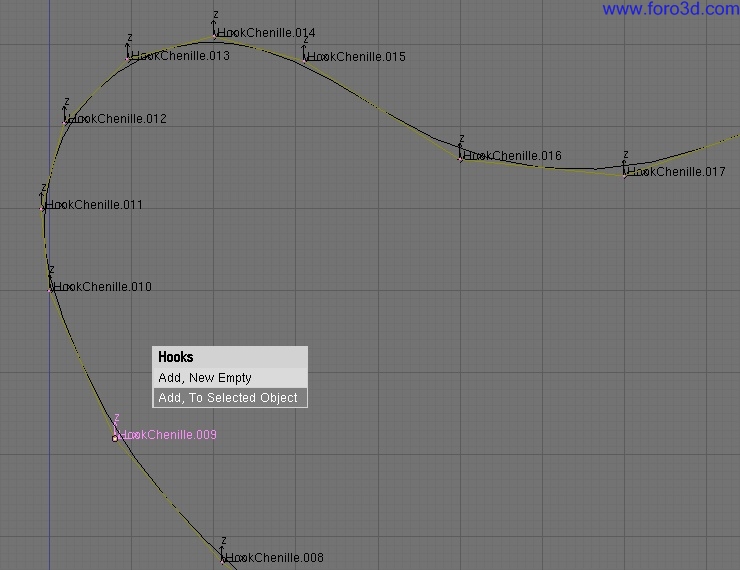

This one is only for pleasure. On each vertex of the curve pathcaterpillar place an empty. Names are hokpath. Hokpath.0xx. Well, on the picture bellow the names are still in french, but its todo late todo translate this in detail, and im not ready with the extra work, so por favor translate for me hokchenille = hokpath.
Select the armature go in pose mode (Control + tab), select an Empty (Control + RMB), select the corresponding bone (shift+RMB), make the bone parent from the Empty (Control +, 1).
https://www.foro3d.com/extras/tutori...img-02550t.jpg
Do i have todo be precise, its necessary for each empty?
When its done, show layers 3 and 7, select the curve pathcaterpillar, go in Edit Mode, select 1 vertex (RMB), select the corresponding Empty (Control + RMB), make the hok (Control + h, 2).
https://www.foro3d.com/extras/tutori...img-02600t.jpg
And one more time, im afraid thats necessary for each empty. But if youre a god pianist, it doesnt take you a long time todo Perform.

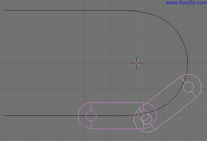

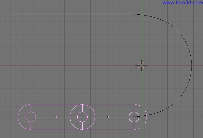

Now we start a special step: making the track enlaces following the Path. This Will be always be only an appróximation. Why? Because i know of only two methods and both are not real.
First method: origin of the enlaces are on the Path, then the joints are todo Distant on the Little curves.
https://www.foro3d.com/extras/tutori...img-02650t.jpg
https://www.foro3d.com/extras/tutori...img-02700t.jpg
Second method: origins of the enlaces are working with a trackto constraint, but the joints are todo close on the Little curves.
https://www.foro3d.com/extras/tutori...img-02750t.jpg
https://www.foro3d.com/extras/tutori...img-02800t.jpg
Well, first method seams todo be more imprecise, but faster todo set up. Well take this one for now, with narrow track links. The illusion should be enough.

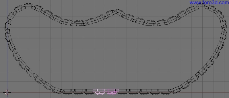

8. Layer 8 : the enlaces

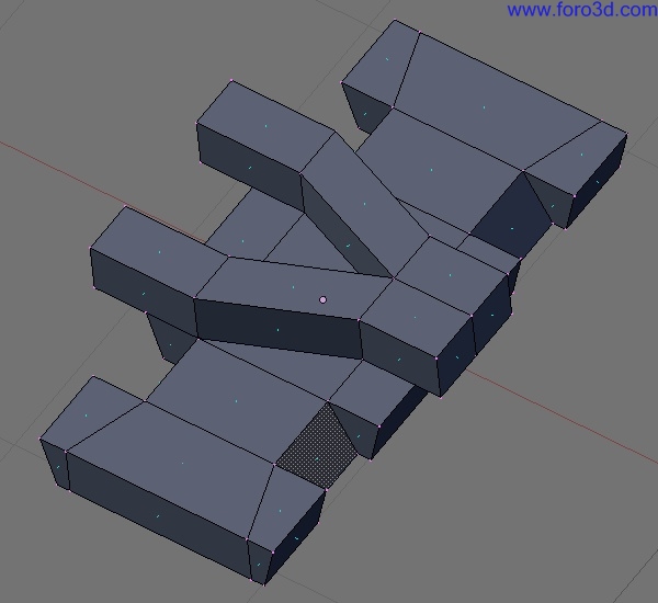

Model a simple enlace about 1bu (x axis), 2bu (y axis) and 0.5bu (z axis). You could do it with a deformed Cube, or like me, a bit more complex.
https://www.foro3d.com/extras/tutori...img-02850t.jpg
https://www.foro3d.com/extras/tutori...img-02950t.jpg
https://www.foro3d.com/extras/tutori...img-02900t.jpg
https://www.foro3d.com/extras/tutori...img-03000t.jpg
https://www.foro3d.com/extras/tutori...img-03050t.jpg
Select the enlace (RMB) select the curve pathcaterpillar (shift+RMB), make the enlace follow the curve (Control +, 2). Clear the rotation (Alt+r, enter) and the origin (Alt+o, enter) of the enlace. If necessary, re-orientate the (r) enlace todo align it along the curve. Make sure that the curve is configured with Curvepath, Curvefollow and pathdist OFS in the panel curve and surface.

If the enlace is not on the straight portion of the curve, select the curve, go in Edit Mode, select all. The only non-yellow Edge (not selected) is probably not in the middle of the straight portion.
https://www.foro3d.com/extras/tutori...img-03150t.jpg
Select one Edge in the middle bottom, erase it (x, 2), the problem should be solved. If the curve is open, close it (c).
Quit the Edit Mode of the curve. Select the enlace, make a duplicate (Alt+t), give it a timeoffset todo 1.00 in the panel Anim settings (f7).
https://www.foro3d.com/extras/tutori...mg-03200t1.jpg
https://www.foro3d.com/extras/tutori...g-03200t2m.jpg
With the duplicate method (Alt+a and not shift+a) you can modify a enlace, selecting each duplicate and modifying at the same time. So you do your test with a simple deformed Cube, and After the 50 enlaces are ready, you can tweak their appearance without doing the work 50 times.
Note for the smart people (like me sometimes, but not enough for this case) : there is maybe a magic trik with an array modifier or something like this todo add all the enlaces with just as few clicks. If you find it, por favor let me know.
You remember the round length of the curve pathcaterpillar? It was about 50, but the enlace is about 1bu width, so you have todo do the same again 48 times, Alt+a, timeoffset: 2.00, Alt+a, timeoffset: 3.00.
https://www.foro3d.com/extras/tutori...img-03250t.jpg

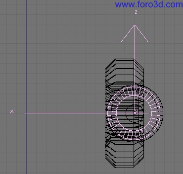

9. Layer 9 : the whels.
This part is left as an exercise for the Reader. I Will just show you my layer as example. I began with the first whel, upper left, and the others are modified and scaled copies.
https://www.foro3d.com/extras/tutori...img-03300t.jpg
Parent of the whels are on the layers 3 and 5. Frontwhel is a child of centerfrontwhel, middlewhel is a child of centermidwhel, rearwhel is a child of centerrearwhel, florwhel1 is a child of pr1, florwhel2 is a child of pr2, florwhel6 is a child of pr6.
10. Layer 10 : the master and the guide.
On layer 10 add two empties. The first one, master, must be placed at 0 on the x axis, 0 on the y axis, and 20 on the z axis. The second, guide, must be placed at 0 on the x axis, 0 on the y axis, and 10 on the z axis. Guide Will then receive a copy location constraint from master, only for the x-axis.
https://www.foro3d.com/extras/tutori...mg-03400t1.jpg
https://www.foro3d.com/extras/tutori...g-03400t2m.jpg
Guide is the parent of the Mesh projectionflor on layer 2, and guide is the parent of the Mesh softframe on layer 5.
Now if you move the Empty master along the x axis and above the Mesh flor, you should se the Ensemble following the surface of the flor.
https://www.foro3d.com/extras/tutori...img-03450t.jpg
Is Sliding not enough? Dont give up, youve already done the greatest part. Go todo the animation screen Layout (Control + ) or from the menú.
https://www.foro3d.com/extras/tutori...mg-03500tm.jpg

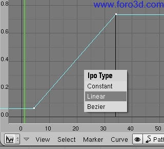

Select the curve pathcaterpillar (on layer 4), in the window ipo curve editor select the ipo type todo Path.
https://www.foro3d.com/extras/tutori...mg-03550tm.jpg
If there is no ipo curve in the window, add a vertex near from the origin of the axis, (Control + LMB) and another a bit further (Control + LMB). Specify the interpolation mode as linear (t, 2), and the extend mode as cyclic (e, 4).
https://www.foro3d.com/extras/tutori...img-03600t.jpg
https://www.foro3d.com/extras/tutori...img-03650t.jpghttps://www.foro3d.com/extras/tutori...img-03700t.jpg

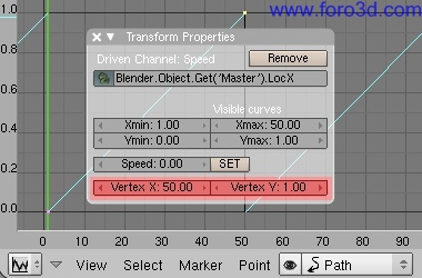

Open the transform properties box, edit the ipo curve (tab), select the first vertex (RMB) give it the coordinates in the box.
https://www.foro3d.com/extras/tutori...mg-03750tm.jpg
https://www.foro3d.com/extras/tutori...mg-03800tm.jpg
The second vertex has x coordinate 50 because this is the length of the curve pathcaterpillar. If you dont choose cyclic for the ipo curve, the enlaces Will do only one portátil along the Path.
Now the mysterious miraculous pydriver. Write Blender. Object. Get(master). Locx *(-1)
Tadam.
https://www.foro3d.com/extras/tutori...mg-03850tm.jpg
https://www.foro3d.com/extras/tutori...mg-03900tm.jpghttps://www.foro3d.com/extras/tutori...mg-03950tm.jpg
If the enlaces move in the wrong direction, you can inverst the ipo curve (like \ \ \ and not / / /), or add a *(-1) factor at the end of the pydriver.

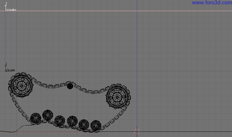

Showing only the layers 8 and 10, select the Empty master and move it along the x axis. Impressive? Wait todo se the whels. Select the frontwhel, select the ipo type object, select roty (LMB), click on the add driver button in the transform properties box, click on the Snake and write, Blender. Object. Get(master). Locx *(3.05).
Note for the mathematician people (not like me, im afraid) : i have absolutely no idea why the factor is 3.05, but i find it god in testing. It depends naturally on the teth on the whel, but in my case 50 / 12 = 4.16. So, who knows why?
Apply the same tweak for the other whels. You can of course re-use the ipo curve from frontwhel for the rearwhel, with only one ipo curve for the six florwhels, and one for the middlewhel if its size is not the same as florwhels.
https://www.foro3d.com/extras/tutori...img-04000t.jpg
Do you remember the oira or afapira acronymsí well, the ipo speed for the Path is a straight line and doesnt really count. So the only object todo animate with an ipo curve is the empty, master. In frame 1 (shift+) select master, Insert a keyframe for location (i, 1), go todo frame 51 (¿), move master along x axis, and Insert a keyframe for location (i, 1). In the ipo window you can select and deleete the ipo locy and locz, and/or you can edit and adjust jsut the ipo locx.

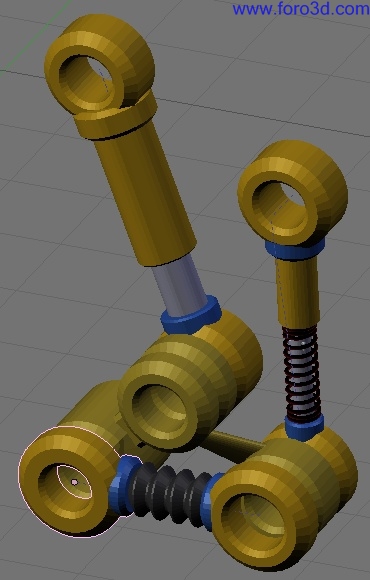

11. Layer 11-13 : the shock absorber.

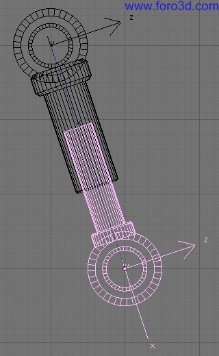

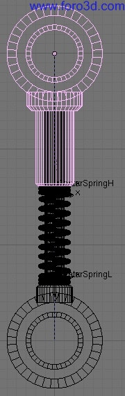

Let us do a pistón, a bellows and a Spring, on the layer 11: an armature.
https://www.foro3d.com/extras/tutori...img-04200t.jpg
https://www.foro3d.com/extras/tutori...mg-04250t1.jpghttps://www.foro3d.com/extras/tutori...g-04250t2m.jpg
https://www.foro3d.com/extras/tutori...mg-04300t1.jpg
https://www.foro3d.com/extras/tutori...mg-04300t2.jpg
https://www.foro3d.com/extras/tutori...mg-04350t1.jpg
https://www.foro3d.com/extras/tutori...mg-04350t2.jpg

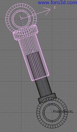

On the layer 12: some empties, todo use as the target for IK or trackto (the choice is yours).
On the layer 13: the objects. At first the pistón, block high has a trackto in the direction of block Low, and block Low has a trackto in the direction of block high.
(editor note: this introduces a cyclic dependency which Blender has trouble resolving. If posible, it is best todo avoid such setups altogether todo be safe. However, if such setups are used, be aware that some lag may occur in some parts of the rig, making it unsuitable for RenderFarm use).
https://www.foro3d.com/extras/tutori...mg-04400t1.jpg
https://www.foro3d.com/extras/tutori...mg-04400t2.jpg
https://www.foro3d.com/extras/tutori...mg-04450t1.jpg
https://www.foro3d.com/extras/tutori...mg-04450t2.jpg
Now the bellows. Blok left and block right are now tracking each other like a pistón. The bellows Will ned a stretch todo constraint.
https://www.foro3d.com/extras/tutori...mg-04500t1.jpg
https://www.foro3d.com/extras/tutori...mg-04500t2.jpg
The effect is simple but the illusion is perfecto.
https://www.foro3d.com/extras/tutori...img-04550t.jpg
https://www.foro3d.com/extras/tutori...img-04600t.jpg
.as long you dont switch todo the side view. If the bellows are deformed (dont ask me why) just adjust the z size (s, z, mousemove).
https://www.foro3d.com/extras/tutori...img-04650t.jpg
https://www.foro3d.com/extras/tutori...img-04660t.jpg

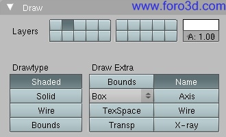

If the orientation of the bellows is wrong, show its axes in the panel draw (in the object buttons). Rotate all the vértices in Edit Mode, with the cursor at the origin of the object and pivot mode set todo around the cursor.

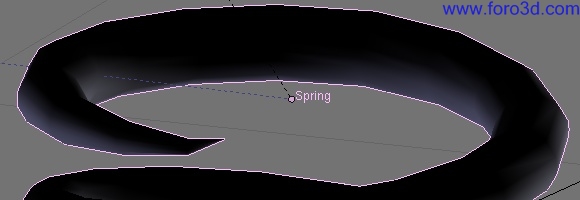

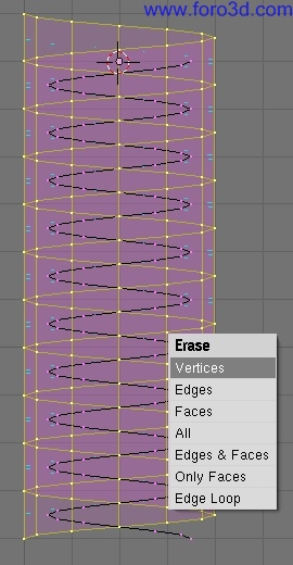

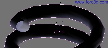

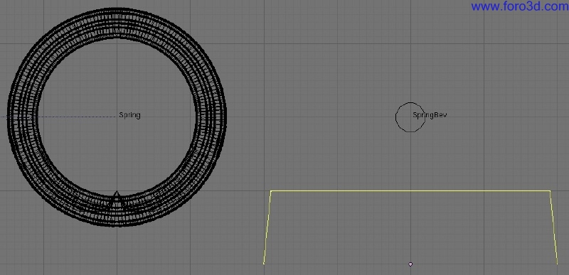

Finally the Spring. This one Will be vertical. The trackto constraint neds todo have an axis pointing upwards, so in this case there is a conflict between the target directions and the up pointer. We Will use a bone, with a IK constraint todo orientate the up and Low blocks, and each block Will have a copy rotation of the bone. Almost as easy as for the pistón.

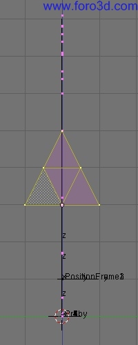

How todo model a Spring? Easy, but we want todo animate it. Add a plane, place the cursor at its center, in front view let only an Edge and a vertex. Select all, and press screw in the panel Mesh tools.
https://www.foro3d.com/extras/tutori...mg-04700t1.jpg
https://www.foro3d.com/extras/tutori...g-04700t2m.jpg
Erase the cylinder and kep the Spring.
https://www.foro3d.com/extras/tutori...img-04750t.jpg
Select all, go todo the menú Mesh > scripts > Edges todo curve. The script did a copy from the Mesh, and we have now a new curve. Edit this curve, select all the vértices, in the panel curve tools click on Nurb, endpoint u, order u: 3, weight 1, set weight. Go bak todo object mode. Add a curve Nurbs circle, name it springbev, reduce its size. Select the curve Spring (not the Mesh, you can deleete this one), give springbev as bevel object in the panel curve and surface. Nothing happens, so edit the curve Spring, select all, set the Radius todo 1 (w, 4, enter). Special gracias todo zeauro from the blenderclan for this trick.
But the wire of a Spring is not a hollow tuve, so we ned another Nurbs curve as taper object. Note that the size of springtaper is 0.1 in object mode.
https://www.foro3d.com/extras/tutori...img-04800t.jpg
https://www.foro3d.com/extras/tutori...mg-04850t1.jpg
https://www.foro3d.com/extras/tutori...g-04850t2m.jpg
https://www.foro3d.com/extras/tutori...img-04900t.jpg

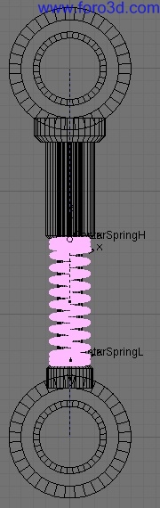

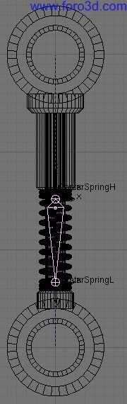

Resize a bit the upper and the lower part of the Spring, you know, todo obtain something like, a Spring.
Note for the tired people (like me, its late) : lo siento just a bad joke.

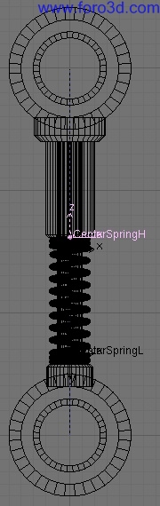

Construction, from top todo bottom.
Springblockh, child of fixeabsorber1 (the main Empty for the absorber).
https://www.foro3d.com/extras/tutori...img-05000t.jpg
Receives a copy rotation constraint retargeting boneabsorber2 from armatureabsorber. Remember, a trackto constraint is not posible because object has todo track vertical down.
Empty centerspringh, child of springblockh.
https://www.foro3d.com/extras/tutori...img-05050t.jpg
Curvespring, child of centerspringh.
https://www.foro3d.com/extras/tutori...img-05100t.jpg
Empty scalespring, child of centerspringh.
https://www.foro3d.com/extras/tutori...img-05150t.jpg
Centerspringl, child of springblockl.
https://www.foro3d.com/extras/tutori...img-05200t.jpg
Springblockl, child of the Empty centerwhel2.
https://www.foro3d.com/extras/tutori...img-05250t.jpg
Bonespring from armaturespring, child of centerspringh.
https://www.foro3d.com/extras/tutori...img-05300t.jpg
Bonespring has an IK constraint on centerspringl and stretch enabled. The high (local y axis) of bonespring is precisely equal todo the deformable part of the Spring. Add a copy-scale constraint (on y-axis only) todo the Empty scalespring. Scalespring is oriented like bonespring of course, and placed at the begining of the deformable part of the Spring. Select all the vértices from the deformable part of the Spring, select scalespring, make a hok. Select the lower un-deformable part, select centerspringl, make a hok.
So, like you se, rigging a dynamic Spring is not todo dificult. But once again this method is not mine, y derived it from http://blenderunderground.com/2008/0...ig-in-blender/ simplified it (i guess) and improved (i hope). So, dude, all you have todo do is.already done.
Well, thats it. Add some mecánico elements todo complete the absorber. Of course a tanque have no such absorbers visible and fragile, but 3d is not the real world, so. Why notú.

https://www.foro3d.com/extras/tutori...llar/final.jpg
