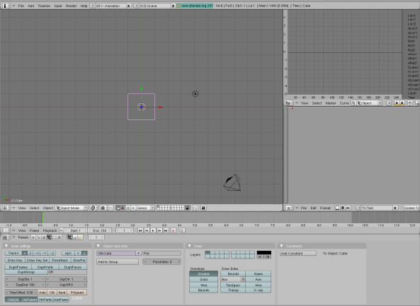

3. Click sr:2-model and change it todo sr:1-animation:
Layout menú
4. Split the right-hand side of the 3d view window into two new Windows.
5. Set the upper window todo the ipo curve editor.
6. Set the lower window todo the text editor.
7. Remove the outliner window todo increase the 3d view space, resulting in:
Blender Layout.

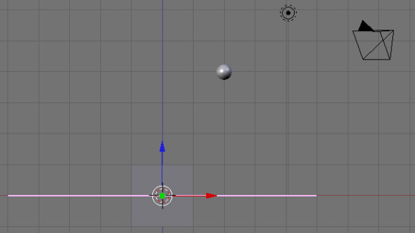

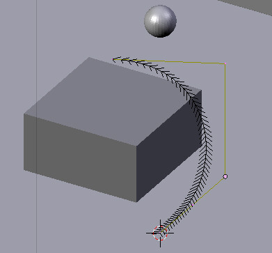

10. Add » curve » Path, then [tab] todo exit edit-mode.
11. Press [g], [y], 2 then [enter] todo move the Path back.
12. Press [g], [z], 0.25 then [enter] todo move the Path up.
This Will align the Path first vertex with the sphere center. After it falls, the sphere Will move along the Path. There are other ways todo align vértices that dont rely on premeditated positioning, as in step 18.
13. Object » mirror » x local.
14. Press [numpad7] for a top view.
15. Press [tab] todo edit the Path.
16. Press [a] todo deselect all vértices.
17. Click RMB todo select the last vertex (left-most).
18. Press [shift+s] then click selection -> cursor.
19. Press [g], [z], 1.5 then [enter] todo move the last vertex up.
20. Click RMB todo select the second-last vertex.
21. Press [g], [x], 1 then [enter] todo align the second-last vertex with the last.
22. Press [g], [z], 2 then [enter]to move the second-last vertex up.
23. Click RMB todo select the first vertex (right-most) and press [shift+s], then click cursor -> selection.
Rotating the scene should show a view similar to:
https://foro3d.com/attachment.php?at...1&d=1245711579
Properly positioned Path.

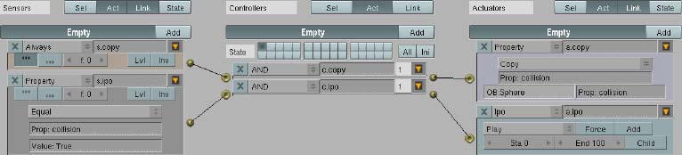

The logic should look similar to:
Logic blocks for the empty.
The logic block instructs Blender todo continually copy the sphere collision property into the Empty property of the same name. Once the collision property is set todo true, the Empty is instructed todo replay its ipo. All that remains is todo set the sphere parent todo the empty, remove the parent relationship when appropriate, and récord the sphere complete ipo curve.

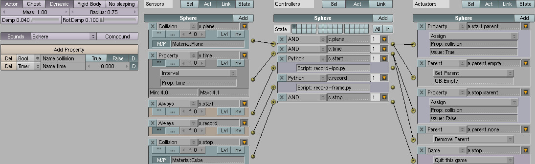

Logic blocks - Sphere - Controllers
1. Under the controllers panel, click add, below controllers, five times.
2. Change the name of the controllers, from top todo bottom as:
I, c, plane.
I, c, time.
I, c, start.
Iv, c, récord.
V, c, estop.
3. Change the default controller type from and todo Python for c, start and c, récord.
4. Create a new text file in the text window by clicking the arrows next todo the datablock name and clicking ad new.
5. Copy and paste the following code into the text window.

10. Under the controllers panel, set the value of script: for controller c, start todo récord-IPO, py.
11. Likewise, set the value of script: for c, récord todo récord-frame, py.
12. Under the Actuators panel, click add, below Actuators, five times.
13. Change the type of Actuators, from top todo bottom as:
I. Property.
I. Parent.
I. Property.
Iv. Parent.
V. Game.
14. Change the name of the Actuators, from top todo bottom as:
I, a, start, parent.
I, a, parent, empty.
I, a, estop, parent.
Iv, a, parent, none.
V, a, estop.
15. From top todo bottom:
I. Set the prop value of a, start, parent todo collision.
I. Set value of a, start, parent todo true.
I. Set the ob value of a, parent, Empty todo empty.
Iv. Set the prop value of a, estop, parent todo collision.
V. Set value of a, estop, parent todo false.
Vi. Change set parent of a, parent, none todo remove parent.
Vi. Change start new game of a, estop todo quit this game.
16. Link sensors todo controllers todo Actuators:
Logic blocks for the sphere.
