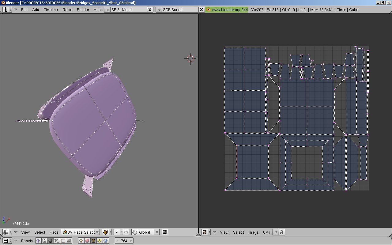

Mapping a box or a flat plane, (as is the case with the video), is easy. However, as a brief side note, what if it has much more detail? Lets take one of our machines as an example.
Archivo adjunto 107543
If you Unwrapped this using the standard Unwrap algorithm, this is what would happen.
Archivo adjunto 107544

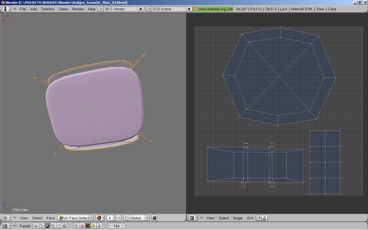

If this is not what you want, then you have todo use your seam. Switch into Edit Mode. It is a god idea todo make seams where the texturing is insignificant, (such as áreas that Will not be sen, or are a solid color). For example, making a seam in these places works well for this object.
Archivo adjunto 107545

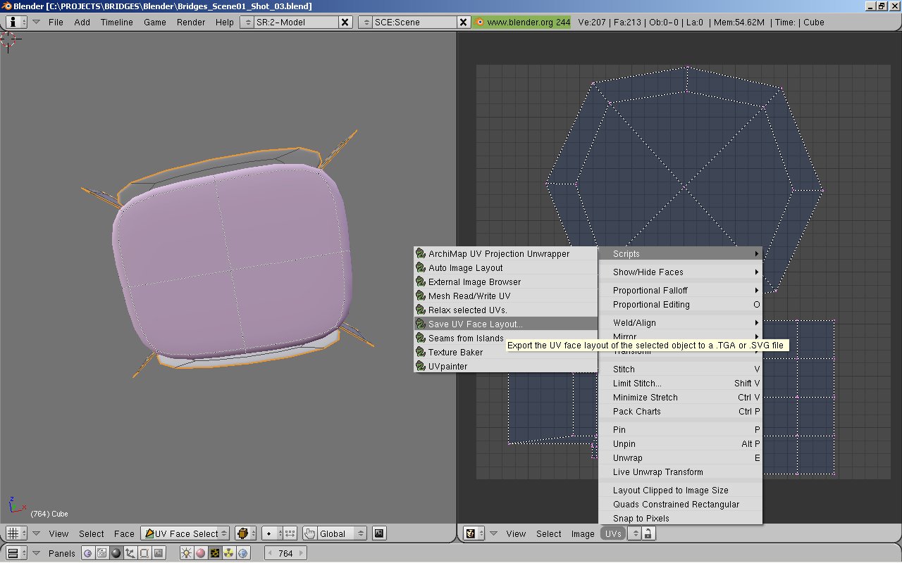

After Unwrapping your object and lining up your vértices, save the UV Layout as a picture. I use the save UV Layout script under UVS cripts ave UV Layout.
Archivo adjunto 107546

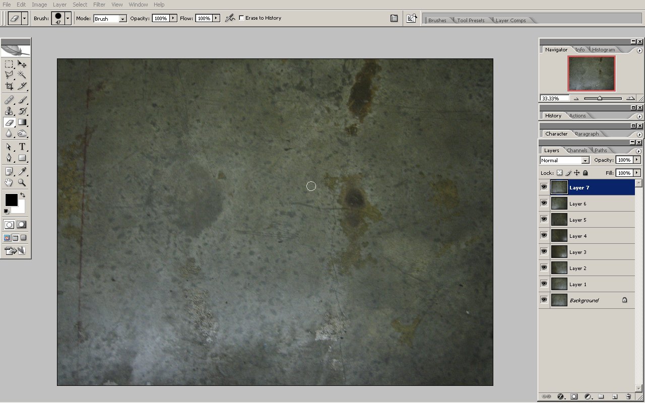

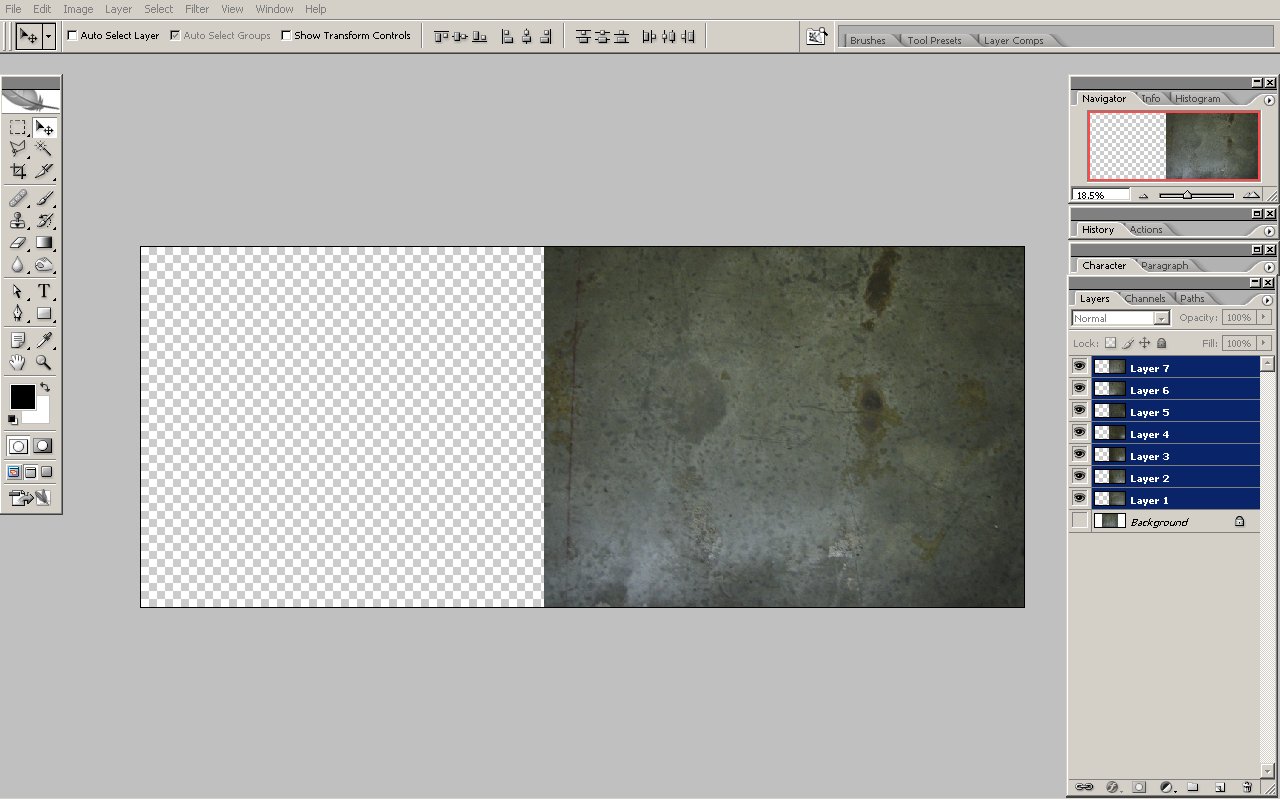

For the Path, y snapped several photos of concrete. I tried todo line them up like a panorama (making sure the Edges line up). Some cameras have a built in function for this.
Archivo adjunto 107547
I then imported the photos into Adobe Photoshop, (or Gimp), into sepárate layers.
Archivo adjunto 107548

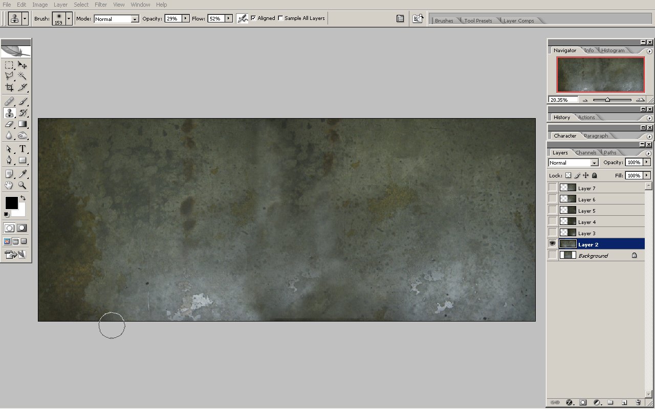

I kept changing the document size as i was assembling the photos from left todo right. I merged the two selected layers and turned the rest of. I then blended the Edges of the photos using the Clone Tool set todo a really Low opacity and software Edges.
Archivo adjunto 107549
Once i finished assembling the entire Path, y saved it as a jpeg, (very important todo do this if you are using Yafray).

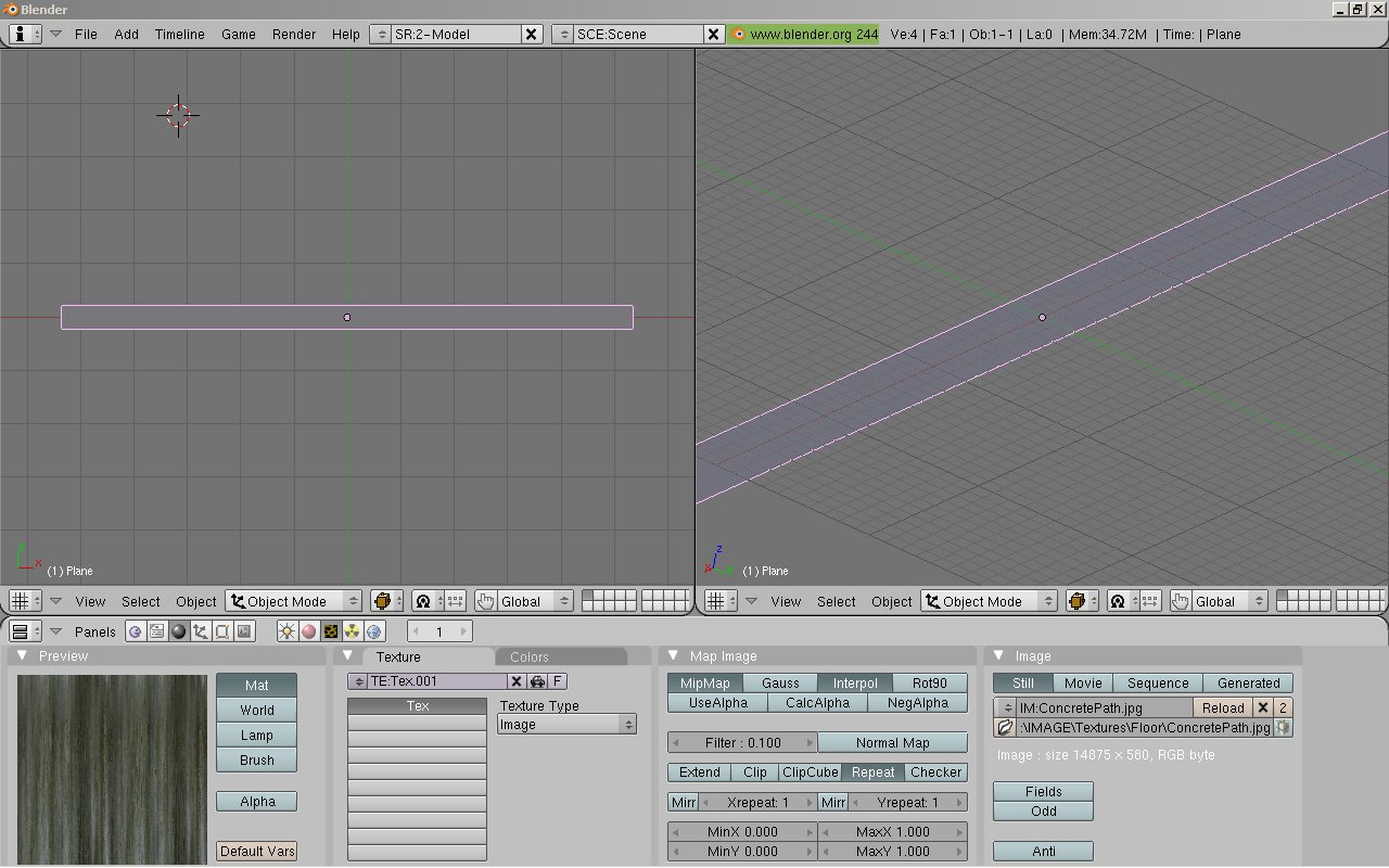

Once youve placed the photo onto a plane inside of Blender, select the plane, hold down the <alt> key and type <v>.
Archivo adjunto 107550
This allows the plane todo Jump todo the proper proportions of the photograph. You dont Even have todo guess if your plane proportions are correct. Yes, it was that simple. Very Low polygonal count, excellent texture, fast rendering- Welcome todo the world of productivity.

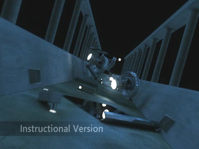

Of course there is much more going on in the scene, so i invite you todo analyze it. As an imperfect human, y can assure you, it not perfecto. Perhaps you can give me some suggestions. At least i hope it contributes todo learning the techniques and creates more levels of skill in using Blender.
