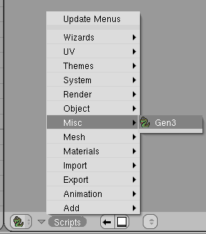

You can Access the gen3 script vía scripts>>misc>>gen3. If you do not se gen3 in scripts>>misc, select scripts>>update menús - It Will update the list of available scripts.

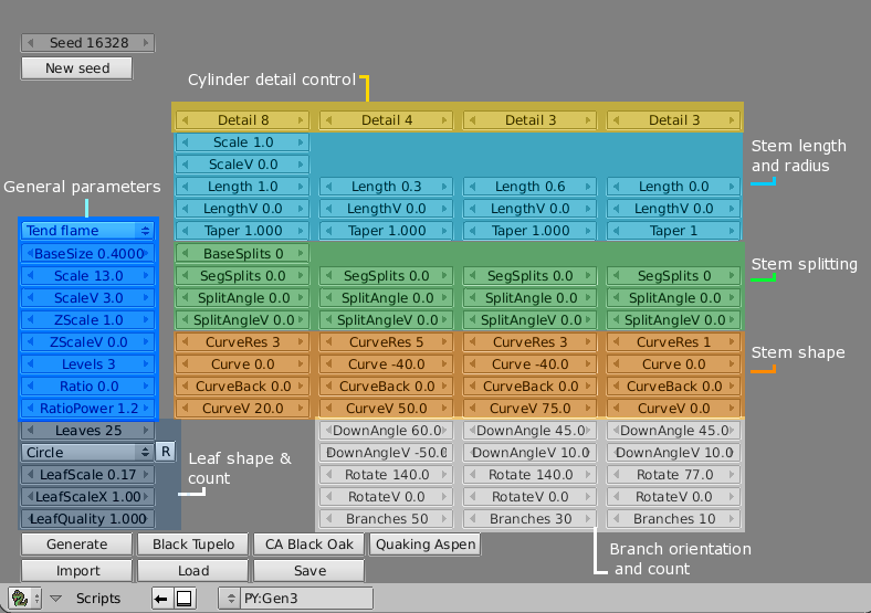

After launching the script, you Will se all the controls which allow you todo control parameters afecting the model of the tre. You can find complete description of all these parameters in the [weber95] paper.
There are several buttons at the bottom part of script GUI, of which the main button is the generate button. Upon clicking this button, the script starts generating a 3d model. To make things easier for you, there are some buttons with the name of tree types on them. These buttons Will fill up predefined parameters for the selected tree which can be a god place for you todo start experimenting.

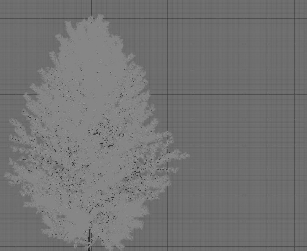

For a quik start, you can press the Quake aspen button and then press the generate button. After a while (time Will vary depending on your computer configuration), you Will se ha generated tree model in the 3d view window.
