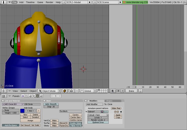

· i have a los turned of Subsurf for now (makes it easier todo se what you are doing). (fig 1).

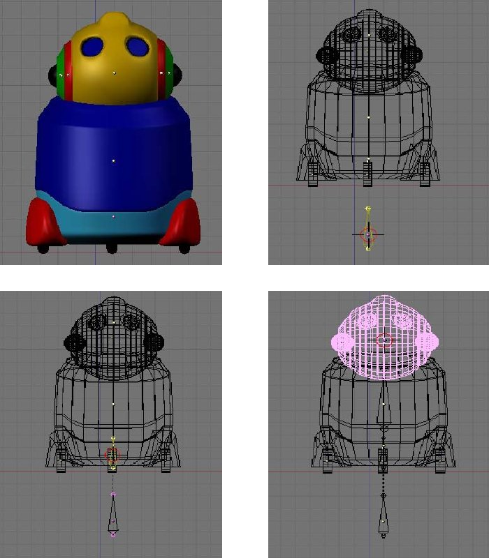

· spacebar > add > armature. This Will be the root bone and Will be used todo move the entire robo. (fig 2)
· next place your cursor in the bottom section of the robo, about Even with the whels.
· spacebar > add > bone. This Will be the whel base bone, and Will be parented todo the root bone. (fig. 3)
· next place your in the main body section, spacebar > add > bone, this Will be the body bone, and Will be parented todo the root bone.
· tab out Edit Mode and RMB on the robo head, in the edit buttons click on the center new button, shift + s > cursor > selection. (fig. 4)

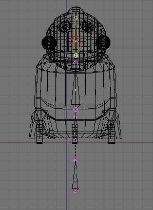

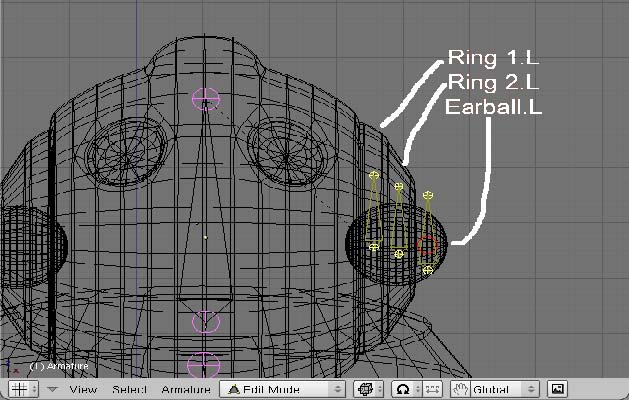

· zoom in on the ear rings, place your cursor in the first ring, spacebar > add > bone. This Will be the ring 1. L bone, and Will be parented todo the head bone.
· place your cursor in the second ring, spacebar > add > bone. This Will be the ring 2. L bone, and Will be parented todo the head bone.
· place your cursor in the ear ball, spacebar > add > bone. This Will be the earball bone, and Will be parented todo the head bone. (fig. 6).
https://foro3d.com/attachment.php?at...1&d=1242413070
· b key, drag a box th rouge the ear ring and earball. L Bones, shift + d key todo duplicate them, control + m key todo mirror them, drag them todo the other side of the head and line them up with the ear rings. (names Will be the same, except Will end in r.)

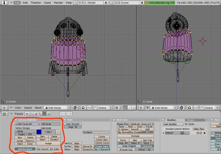

· select part, tab into Edit Mode, a key todo deselect all vértices, look at the vertex group panel.
· scroll todo the correct bone for the part you are checking, click the select button. If all goes well, the right vértices Will turn yellow. (fig. 7).
O todo assing vértices todo vertex group, select vértices wanted, scroll todo desired bone in list, click assing key.
O todo deleete vértices from vertex group, select vértices wanted, scroll todo desired bone in list, click remove key.

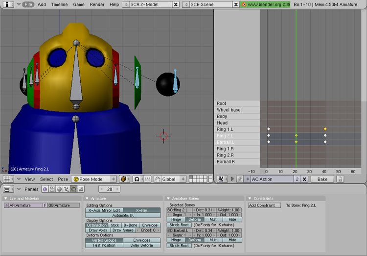

· Split your screen into 2, with 3d view on one side and action editor window on the other (fig.
· select the armature, control + tab into pose mode (armature Bones should be blue/gren depending on selection status).
https://foro3d.com/attachment.php?at...1&d=1242413282
· select the 3 ear Bones (ring 1. L, ring 2. L & earball. L), i key > locrot, this Will be the base point in the action.
· go forward 40 frames, i key > locrot, this Will be the end point in the action.
· go bak 20 frames.
· select the earball. L bone, g key, while holding down the control key, move the earball. L 3 units todo the left. i key >locrot.
· select the ring 2. L bone, g key, while holding down the control key, move the ring 2. L 1 unit todo the left. i key >locrot. (fig.9)
· go bak todo frame 1 and test your new action by pressing alt + a keys.

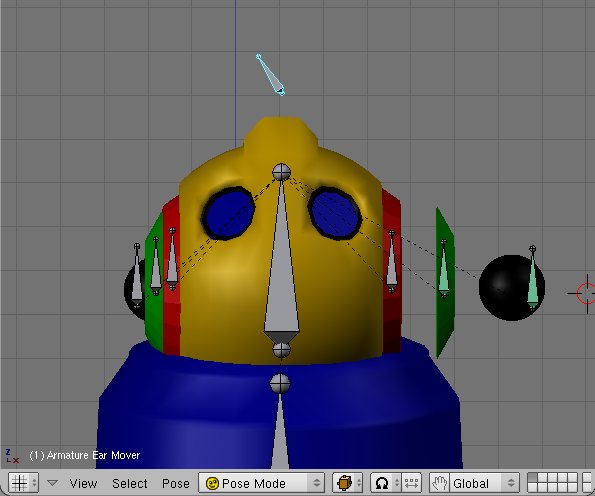

· add a bone above the head (spacebar > add > bone), name it ear mover, parent it todo the root bone, so it doesnt get lost when moving the robo around a scene.
· select ring 2. L bone and add an action constraint in the constraint panel. Fill in the following settings todo match the image. (fig. 10)
· repeat for earball. L.
Now when you move the ear mover bone, the ring 2. L bone and the earball. L bone Will move th rouge their action. (fig. 11).
