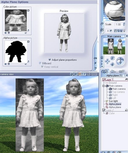

The easiest bien todo bring a photo/picture into Vue is todo use an alpha plane. To Illustrate the process i used an old photo of me (a very old photo) and loaded it as a color picture. In my graphic programa i deleted everything that i didnt want todo be displayed and filled that área with white color. I selected the white área and inverted the selection. Now my body was selected and i filled the área with black color. I saved this black and white picture and opened it as alpha picture. I selected adjust plane proportionesto kep the proportions of the original picture. Here you can se the result:
Archivo adjunto 166911
Bak on the working spaceyou can resize the alpha plane and place it wherever you want it. If it todo dark enter the material editor and go todo the effects tab. Increase the luminosity till it looks right. So you wont have todo use a sepárate light source todo light up the picture. I hope this Little tutorial is helpful.
